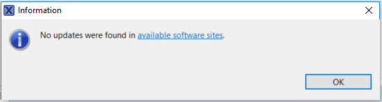

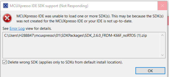

MCU Xpresso IDE wont load SDK 2.6.0,
I did Help>Check for updates and no updates

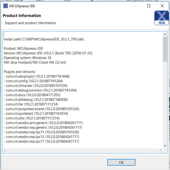

Hi Jeff:
Please download MCUXpresso 11 from below link.
MCUXpresso IDE|Eclipse-based Integrated Development Environment (IDE) | NXP
SDK 2.6 should be work with MCUXpresso 11.
