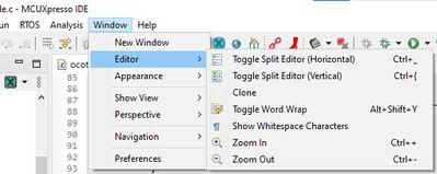

When using a very high resolution display (4K) the MCUXpresso v11 toolbar height is extremely tiny. Is there a way to make it larger.

ErichStyger
Specialist I
I don't have such a display, so cannot try it out. But some of my students had the same problem, so I wrote an article which helped them to solve it:
https://mcuoneclipse.com/2017/10/11/dealing-with-eclipse-and-very-small-icons-on-ultra-high-density-...
Can you check if this works for you?
Erich
2,552件の閲覧回数
HPT_Dave
That did the trick! Thanks to you and your students for the help!
Dave

Miguel04
Hi @HPT_Dave
No there isn't a way to zoom in the toolbar, only the text editor.
Here you can zoom in the text editor, in case this also is an issue.
Let me know if you have another question.
