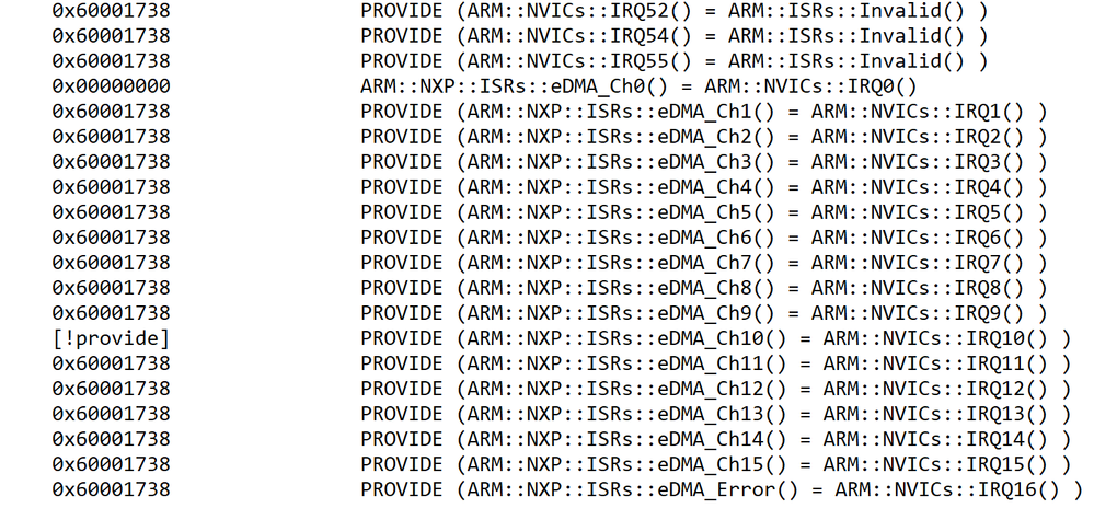

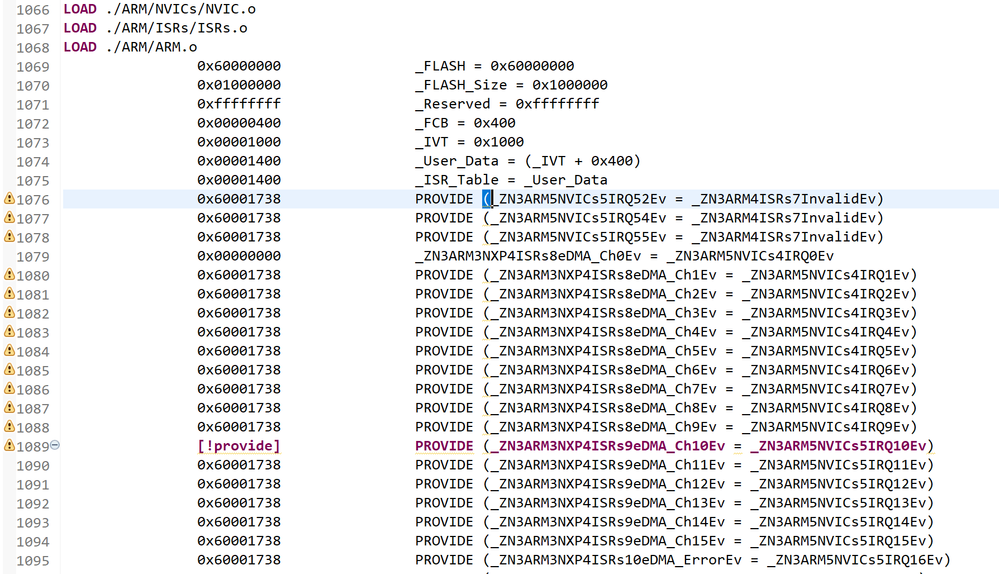

To demonstrate, I've included a screenshot of an actual .map file of mine, that shows where the map file parser complains - and notably, where it doesn't. Unlike my cut-down example above, however, it uses C++ name mangling, so see below the image for an explanation of what I'm doing, and why.
But please note the actual values assigned by the linker and reported by the map file: I've deliberately altered one of the lines to not use PROVIDE(), and you'll see that the linker does the wrong thing with a 0x00000000 value - but at least the map file parser doesn't complain about that line. Also note that as soon as the linker doesn't need to do a PROVIDE (indicated by "[!provide]"), from then on the map file parser stops complaining about the syntax of lines that it complained about before - but that might also be because for some reason it's opened a group (note the blue circled minus on that line):
For ease of explanation, I've demangled the C++ names:
    0x60001738                PROVIDE (ARM::NVICs::IRQ52() = ARM::ISRs::Invalid() )
    0x60001738                PROVIDE (ARM::NVICs::IRQ54() = ARM::ISRs::Invalid() )
    0x60001738                PROVIDE (ARM::NVICs::IRQ55() = ARM::ISRs::Invalid() )
    0x00000000                ARM::NXP::ISRs::eDMA_Ch0() = ARM::NVICs::IRQ0()
    0x60001738                PROVIDE (ARM::NXP::ISRs::eDMA_Ch1() = ARM::NVICs::IRQ1() )
    0x60001738                PROVIDE (ARM::NXP::ISRs::eDMA_Ch2() = ARM::NVICs::IRQ2() )
    0x60001738                PROVIDE (ARM::NXP::ISRs::eDMA_Ch3() = ARM::NVICs::IRQ3() )
    0x60001738                PROVIDE (ARM::NXP::ISRs::eDMA_Ch4() = ARM::NVICs::IRQ4() )
    0x60001738                PROVIDE (ARM::NXP::ISRs::eDMA_Ch5() = ARM::NVICs::IRQ5() )
    0x60001738                PROVIDE (ARM::NXP::ISRs::eDMA_Ch6() = ARM::NVICs::IRQ6() )
    0x60001738                PROVIDE (ARM::NXP::ISRs::eDMA_Ch7() = ARM::NVICs::IRQ7() )
    0x60001738                PROVIDE (ARM::NXP::ISRs::eDMA_Ch8() = ARM::NVICs::IRQ8() )
    0x60001738                PROVIDE (ARM::NXP::ISRs::eDMA_Ch9() = ARM::NVICs::IRQ9() )
    [!provide]                PROVIDE (ARM::NXP::ISRs::eDMA_Ch10() = ARM::NVICs::IRQ10() )
    0x60001738                PROVIDE (ARM::NXP::ISRs::eDMA_Ch11() = ARM::NVICs::IRQ11() )
    0x60001738                PROVIDE (ARM::NXP::ISRs::eDMA_Ch12() = ARM::NVICs::IRQ12() )
    0x60001738                PROVIDE (ARM::NXP::ISRs::eDMA_Ch13() = ARM::NVICs::IRQ13() )
    0x60001738                PROVIDE (ARM::NXP::ISRs::eDMA_Ch14() = ARM::NVICs::IRQ14() )
    0x60001738                PROVIDE (ARM::NXP::ISRs::eDMA_Ch15() = ARM::NVICs::IRQ15() )
    0x60001738                PROVIDE (ARM::NXP::ISRs::eDMA_Error() = ARM::NVICs::IRQ16() )
