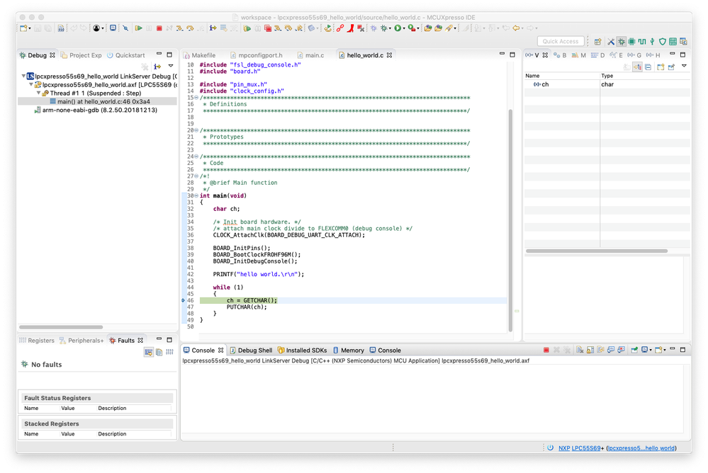

Hi, I found that sometimes I don't get any PRINTF output in debugger Console window. So I reverted to the 'hello world' example and found that also has the problem.
I'm running the 'hello world example from SDK-_2-2, MCUXpresso 11.0.0_2516 for LPC55S69 on Mac OS-X.
When PRINTF works, I see message in Console window (if I recall correctly) about telnet successful, and no such message when PRINTF issn't working.
At one point I wondered if I'd run out of memory/resources so I closed all my other apps and browser windows and then it did seem to work, but that may have been a fluke because that never made it work when it next stopped working.
Is there some log file somewhere that would give info about anything that went wrong?
Screenshot attached where I've stepped past the PRINTF line with no console output.

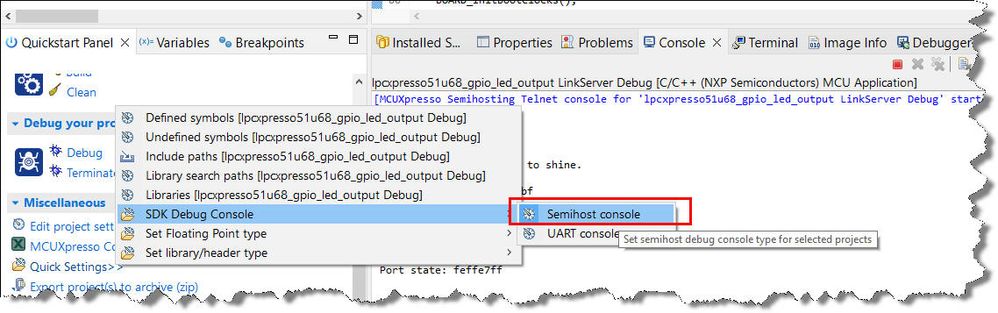

bytemanaccel
About the settings I've found that was set to UART console, to change it:
Quickstart Panel _> Miscellaneous -> Quick Settings -> SDK Debug Console
then you can choose between Semihost or UART.
Regards.

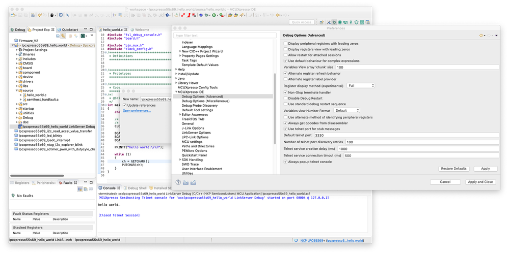

jgreen
Hi Martin,
Here's a few things I found when I had this problem...
1. In the attached screenshot, when starting debugger, if I didn't get message in 'Console' window "[MCUXpresso Semihosting Telnet console for..." then I knew printf output will not be working.
2. I increased timeouts "Telnet service creation delay (ms)" and "Telnet service connection timeout (ms)" and that made it much more reliable.
HTH

mbra16
Thanks! I found out that the settings were somehow switched, using UART for SDK Debug Console. When I put it back to Semihost, it worked again. I'm confident I didn't change it to UART by myself, never the less, the problem is now resolved.

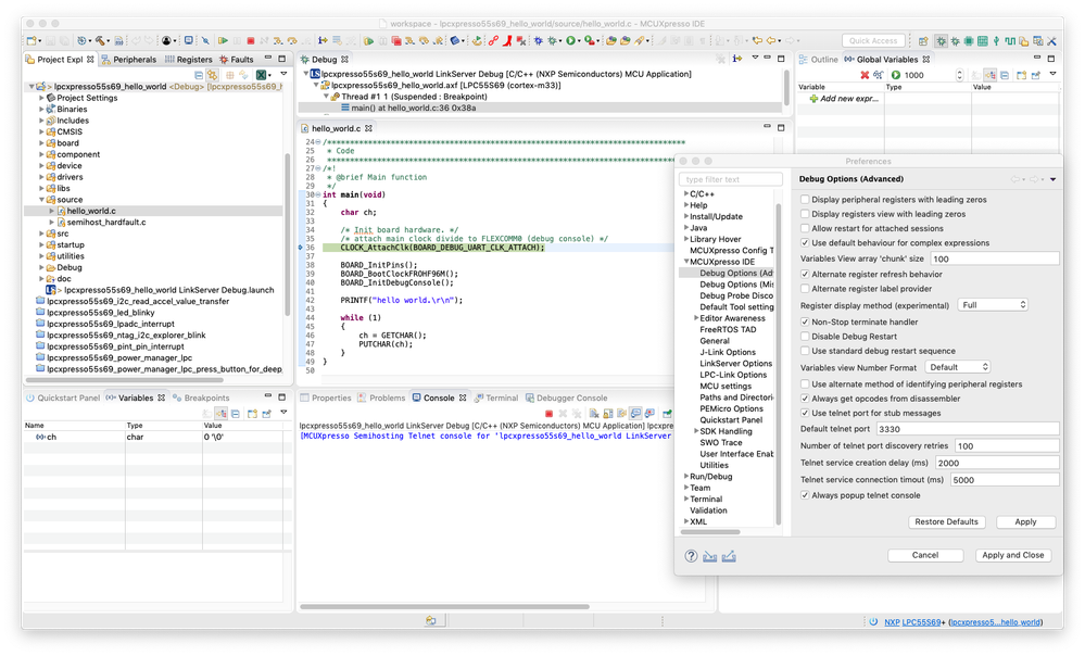

jgreen
Hi MCUXpresso IDE Support, thank for your response.
Regarding your questions...
1. I'm unable to confirm this, but PRINTF to Console does frequently work ok, so Console settings are most likely ok.
2. On my MAC-OSX install I don't have that menu option, but I can get to "Debug Options (Advanced)" via other routes and I do have "Use telnet port for stubbed messages" selected - see attached screenshot.Screenshot 2019-07-31 at 10.14.14.png
My issue is that this sometimes works and sometimes doesn't.
I've attached a screenshot that shows the telnet was started ok this time and the PRINTF to Console worked ok this time. The screenshot also shows my "Debug Options (Advanced)".
Now I know about "Debug Options (Advanced)" maybe I might try extending the timeout period etc on those occasions when I find it isn't working.
Is there some way (e.g. log file) that I can find out what went wrong when the telnet doesn't get started?
Jon.

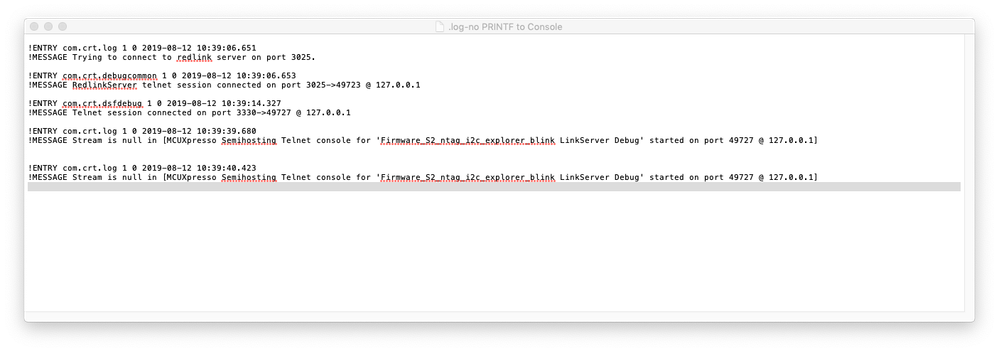

jgreen
I've got a log file for the case that semi-host PRINTF isn't working - see attached.
If my interpretation of the log is correct then call to PRINTF results in log message like this:-
!ENTRY com.crt.log 1 0 2019-08-12 10:39:40.423
!MESSAGE Stream is null in [MCUXpresso Semihosting Telnet console for 'Firmware_S2_ntag_i2c_explorer_blink LinkServer Debug' started on port 49727 @ 127.0.0.1]Screenshot 2019-08-12 at 10.54.18.png
