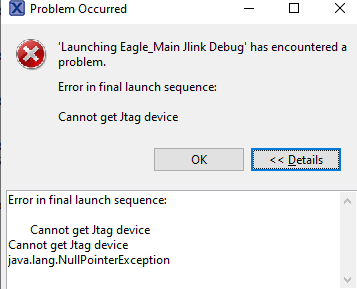

I am using MIMXRT1060-EVK and MCUXpresso 11.7.1 to debug firmware.
but failed to debug via Jlink debugger.
error logs as below:

Please attach the logs (Help => MCUXpresso IDE Save Info for Support)...

s the J-Link listed in your device manager?
Check that you are connecting with SWD and not JTAG (launch config). The debugger console view should give you some more details.
Other than that: https://mcuoneclipse.com/2018/01/28/troubleshooting-tips-failed-debugging-with-gdb/
