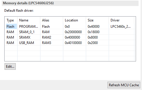

We'll correct the document. The Memory Configuration for the LPC54606J256 is:
SRAM1-SRAM2 are not present on the LPC54606J256 part.
You should note the SDK examples are typically created for an off-the-shelf board, like the LPCXpresso54608 (LPC54608J512). You can request an SDK build for the LPC54606J256 part through the MCUXpresso SDK Builder MCUXpresso SDK Builder. The imported project examples are not necessarily guaranteed to build (or operate) for the LPC54606J256 part, but will supply the correct memory configuration.

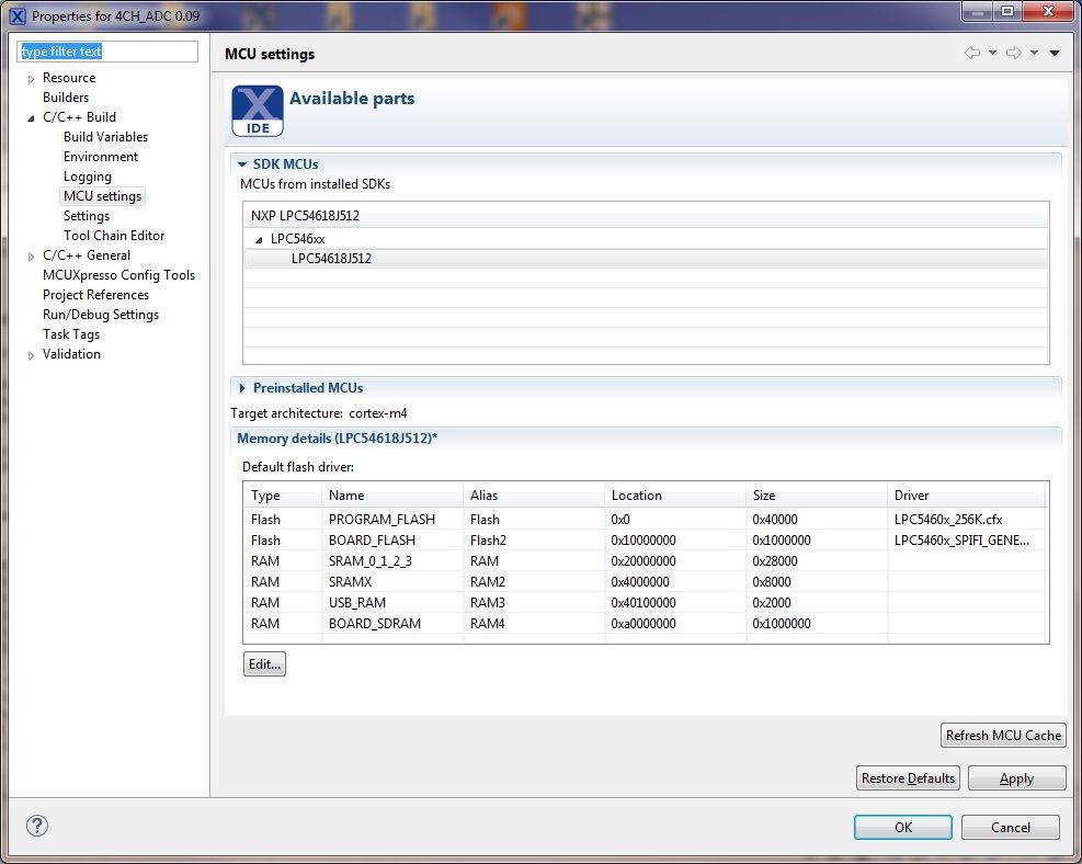

I believe I discovered the problem. It is related to the memory map of the smaller LPC54606J256 device I am using. My program was trying to access RAM that was not there, and for some reason the debugger would not even start correctly because of that. I have my program now running after I changed the "RAM SRAM_0_1_2_3 RAM location 0x20000000" from size 0x28000 to 0x18000. I thought I was okay with 0x28000 as 160KB is the RAM size of my micro, but it must be partitioned differently.
As a follow up question could you tell me where to locate the memory map partition for the LPC54606J256 device? I have been unable to find it in the LPC546xx data sheets, for which I have only found the partitions for the full size LPC54618J512 part. In "MCU settings" for my project, I would select my part under "SDK MCUs" or "Preinstalled MCUs", but my part is not available in the list. So what I am doing is keeping the LPC54618J512 part selected but editing the memory details. Here is a screen shot, showing my settings (after I reduced the FLASH size, but before I reduced the SRAM size).
