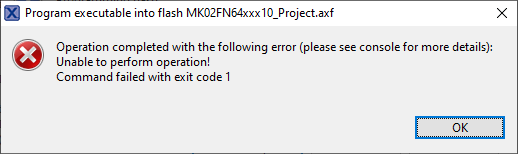

I have a bare board with the MK02FN64. I am using Segger J-Link and MCUXpresso. I can erase, program and read the MCU flash using Segger's J-Link applications.This implies the device and connections are correct.
MCUXpresso's debugger fails to program the flash & results in a Break at address that is outside the program code (not surprising since the flash was never programmed). The GUI Flash Tool also fails to erase or program the flash.

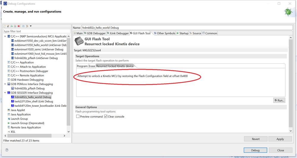

The Console information indicates that the J-Link is connecting to the device. I do notice that when using the Segger J-Link app, I get a message that the Protection bytes in flash at addr. 0x400-0x40F indicate that readout protection is set (don't know how to disable this in MCUXPresso ?? Using the GUI Flash Tool for Resurrecting locked Kinetis devices doesn't have any effect). Within Segger's app, I can unsecure the device & program it. I can can then read the content & verify it. MCUXpresso does nothing to the flash.

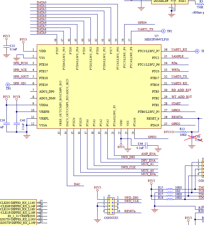

sariley
Attached is the schematic. There is no NMI pin on this package. The reset is pulled up & goes to the ARM 10 pin debugging header.
1,808 Views
jingpan
In MK02FN64VLF10, PTA4 is the NMI_b pin. Please try to add a 4.7k~10k pull-up resistor. More important, it mustn't have any capacitor on this pin. Please also add a pull-up resistor on SWDIO pin.

jingpan
Can you show me the RESET pin and NMI pin connection?

sariley
Version is: MCUXpresso IDE v11.0.0 [Build 2516] [2019-06-05]
Yes, MCUX does find the J-Link debugger.
It runs the unlock function without complaining:
Unlocking device...O.K.
Script processing completed.
Erase works (confirmed with J-Mem app)
But programming & debug do not:

Also, when GUI Flash tool is used:
1,809 Views

jingpan
Hi Steven,
In MCUXpresso, there isn't a special command can be used to erase secure state. A normal erase or mass erase can unsecure the device. Please check the startup_xxxxx.c which is in startup directory. There is a const struct Flash_Config. It should be
Flash_Config = {0xFFFFFFFF, 0xFFFFFFFF, 0xFFFFFFFF, 0xFFFFFFFE};
This value will be written into 0x400~0x40F during program.
