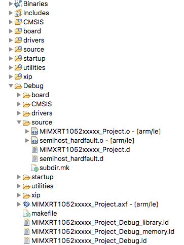

I've just download a fresh copy of the EVK-MIMXRT1050 SDK from mcuxpresso.nxp.com and installed it into MCUXpresso IDE v10.1.0. Then used the "New project..." wizard from the Quickstart Panel to create a new basic project (with all of the options set to the default). When I then click on the Quickstart Panel's Build button, this compiles and then links without any problem.
On your system, once the build has completed (and failed), can you try opening the project up in the Project Explorer view and confirming that a subdirectory called Debug has been created. This should then contain a set of subdirectories, with names matching the names of the directories containing the source code for the project - similar to the screenshot below....
What do you see in your system?

dll file in  https://community.nxp.com/thread/389082
solved the problem..
