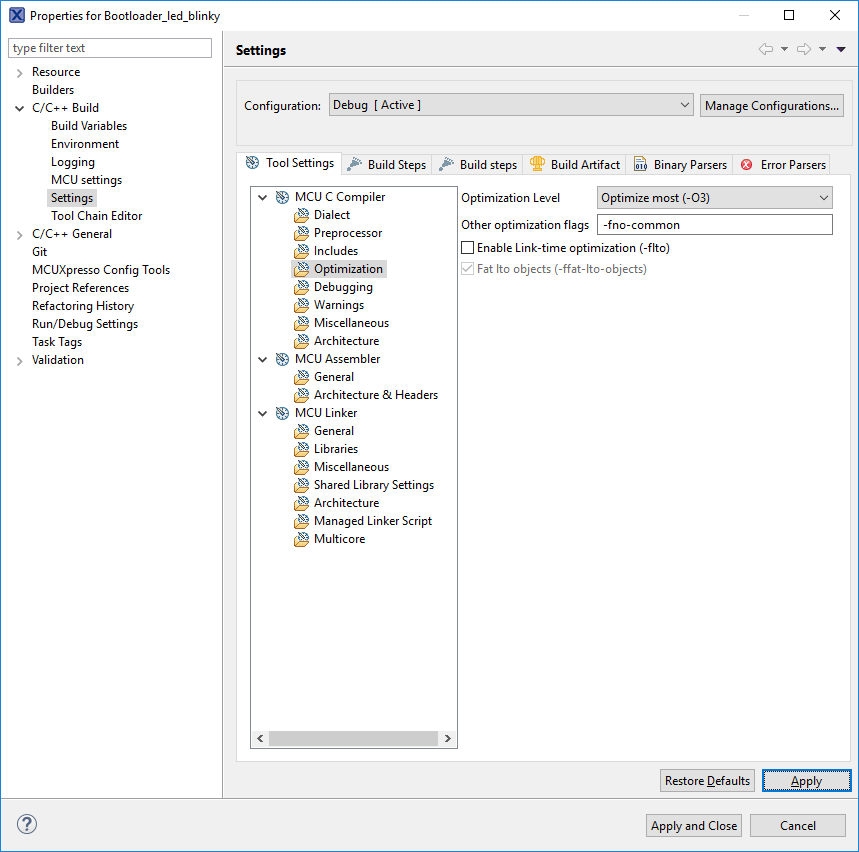

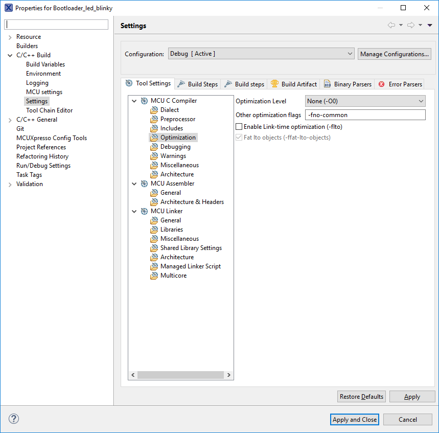

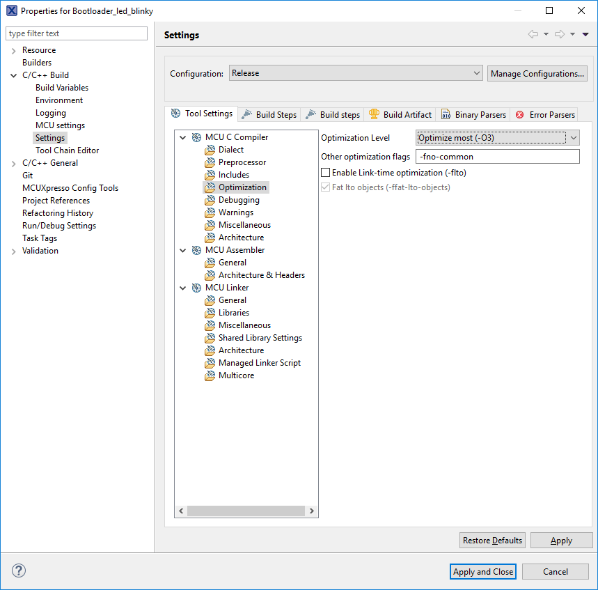

My project has 2 configurations in MCUXpresso: debug and release.  I would like the debug configuration to build with settings that make debugging easier.  The release configuration should have optimizations turned on.
The active configuration for the project is set to Debug.  The Optimization setting for the Debug configuration is set to "None -O0", like it should.  Everything is good here.
So I switched to the release configuration by changing the "Configuration" drop down from "Debug" to "Release", and changed the optimization level to "Optimize most (-O3)".
I then clicked "Apply and Close".  I reopened the project properties, and suddenly the Debug configuration is set with -O3 for the Optimization Level.

I created a new workspace and tried both importing an existing project and creating a new project.  Both have...strange behavior when changing the settings.  For example, I tried changing the Language standard on the Release configuration from GNU C11 to Compiler Default, but the setting changed back to GNU C11 when I clicked "Apply".  I changed it back to Compiler Default, clicked "Apply", and the setting stuck that time.  However, it also changed the Debug configuration Language standard to Compiler Default as well.

I have done some tests and was not able to reproduce the behavior you mention. Could you give me more information about your project? Which device are you using? Is that behavior present in any project or just that specific project? Could it be that the [All Configurations] option was accidentally selected?

The project is configured for the MKV31F256XXX12.  This behavior is present in all of my projects that use the MKV31F series micro controllers.  I created a new project for the LPC8N04, and the settings behave correctly in that project.  The [All Configurations] option was not selected, as shown in the screenshots.
