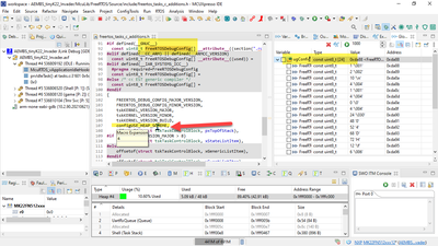

Yes, this is what I use:
On a side note: I'm using the McuLib FreeRTOS port, but that should not matter?

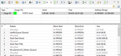

I do use heap #4 a lot, and don't see any problems on my side:
Could you check if that FreeRTOSConfig data structure had been linked with your application and is present?

In my side, the debug info is not what it should be. e.g. FreeRTOSDebugConfig[5] which represent the heap type is always 1 not 4!
Is your screenshot from V11.5 ?
