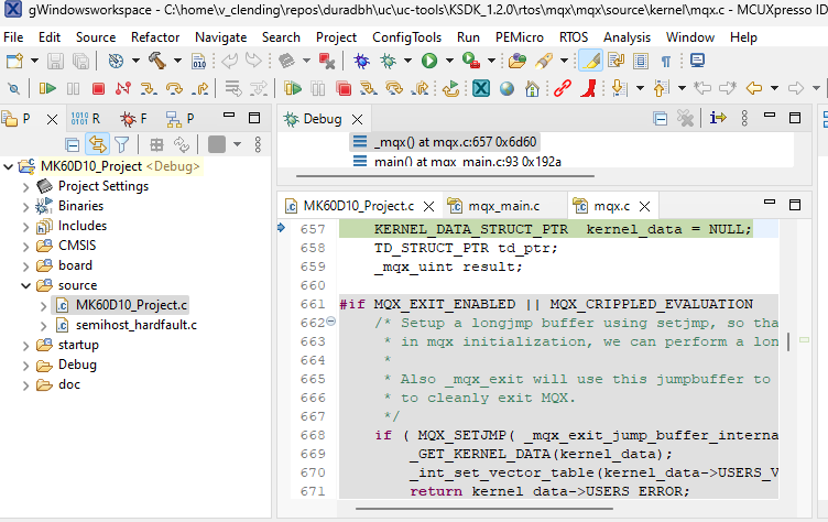

I have inherited a project where cmake creates an ELF. By following this post (MCUXpresso IDE - NXP Community), I can load the project. Debugging works - I start in my source file with my main function. I can step into other files in my project and set break points.
The only problem is that the Project Explorer windows does not show my source code. It only shows code from the default project for the processor. Is there a way to import my source along with the ELF?

I have all the source file for the ELF files and compiled them on my computer. When I start the debugger, the IDE brings up MY source file (mqx_main.c) that contains the entry point for the executable. This file has the correct code and path. I can step into other files (e.g. mqx.c), set break points and run code.
My problem is that I cannot see my files in the Project Explorer window. This means I have no way set break points in other files.
If you look at my picture, MK60D10_Project.c from the board SDK is in Project Explorer window but neither mqx_main.c or mqx.c are there.

Please have a look at ch. "Importing existing executables" from MCUXpresso IDE User Guide. The IDE offers a dedicated import wizard for executables. Please pay attention to all the project settings (e.g. memory map, core, device, board, etc.) because they can all have an impact on the debug experience. You won't be able to build project though (you do this externally with your CMake build system).
Regarding the availability of the source files in Project Explorer, you can link the actual (locally hosted) source folders to the newly created project. Note that once you import an executable, the resulted project is simply a container for the executable and for a set of settings that allow debugging. You can even debug an executable that's built on some other machine, copy sources from the remote machine and then create a source mapping further used by GDB during debug. The use case can get pretty complicated...

"Regarding the availability of the source files in Project Explorer, you can link the actual (locally hosted) source folders to the newly created project"
This is exactly what I need to do but I do not know how to do it.
