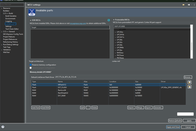

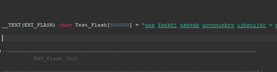

I declare my RAM  using __DATA(RAM3)
And my External flash using __TEXT(EXT_FLASH)

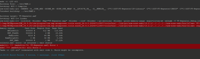

Somehow when I compile the program the linker puts the data of the external RAM in the external RAM AND in the internal flash...
I am out of ideas on why it happens... Is this a bug? is this memory allocation actually working in the first place?

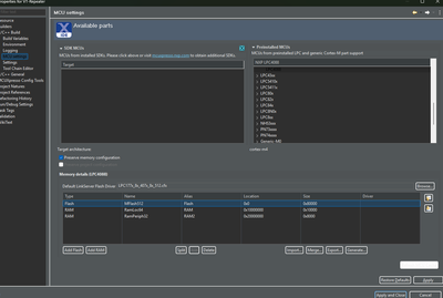

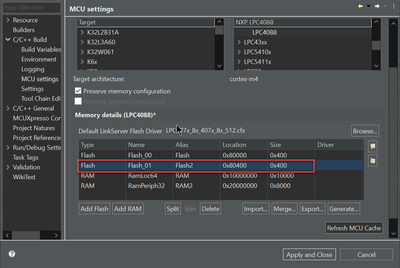

1. Via MCU settings:
Create a new RAM/FLASH in MCU settings, properties->C/C++ build->MCU settings:

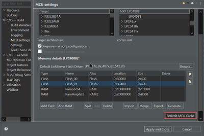

 Click on Refresh MCU cache:
Click on apply and close:

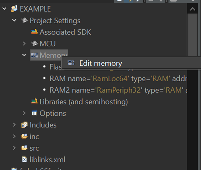

2. Click on Edit memory in Project settings->memory->Edit memory:
Add a new FLASH and press OK :

additionnally I run into the problem of the memory allocation does not persist after a restart of MCUxpresso:
Really what is happening? is this a pre pre alpha release?

To make it clear here i set an array bigger than the flash memory but smaller than the external RAM and the program cannot compile because it copies the memory of the RAM in the flash.........
