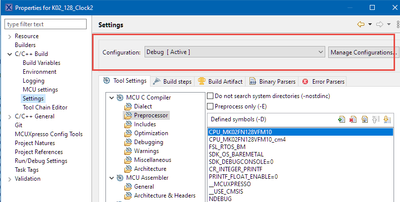

Hi @eoinpauldowling ,
I have been running into the same thing: using the K02 64KByte and K02 128KByte for the same project.
The missing item for the MCU settings is that it lacks the setting for the configuration, to make it configuration aware, as it is present for other CDT setting pages:
I have expressed this as a need in the past and I hope this can be implemented in a future IDE version (keeping fingers crossed).
I solved it with using external folders/libraries: basically the K02_128 and the K02_64 are just the project with a main and configuration files, and everything is in the 'common' part: that way I can keep the things separate and the same time aligned. You might have a look how I did this on https://github.com/ErichStyger/MetaClockClock
Other than that, you might consider a shell script manipulating the .cproject file depending on your needs. I did consider this, but thought my above solution is a more portable one.
