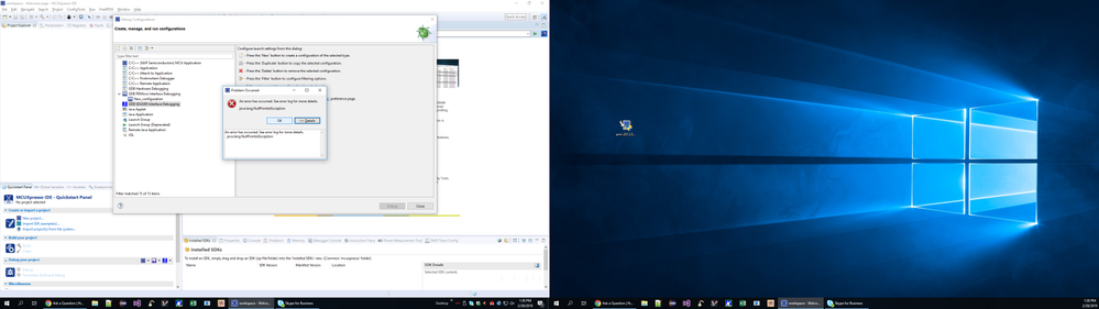

amuresan
MCUXpresso IDE v10.3.1 [Build 2233] [2019-02-20]
When I double-click on SEGGER
This also happens on 10.3.0
java.lang.NullPointerException
at com.nxp.mcuxpresso.core.debug.support.segger.ui.JLinkDebuggerTab.setDefaults(JLinkDebuggerTab.java:268)
at org.eclipse.debug.ui.AbstractLaunchConfigurationTabGroup.setDefaults(AbstractLaunchConfigurationTabGroup.java:77)
at org.eclipse.debug.internal.ui.launchConfigurations.LaunchConfigurationTabGroupWrapper.setDefaults(LaunchConfigurationTabGroupWrapper.java:248)
at org.eclipse.debug.internal.ui.launchConfigurations.CreateLaunchConfigurationAction.performAction(CreateLaunchConfigurationAction.java:80)
at org.eclipse.debug.internal.ui.launchConfigurations.AbstractLaunchConfigurationAction$1.run(AbstractLaunchConfigurationAction.java:107)
at org.eclipse.swt.custom.BusyIndicator.showWhile(BusyIndicator.java:70)
at org.eclipse.debug.internal.ui.launchConfigurations.AbstractLaunchConfigurationAction.run(AbstractLaunchConfigurationAction.java:110)
at org.eclipse.debug.internal.ui.launchConfigurations.LaunchConfigurationsDialog$2.runInternal(LaunchConfigurationsDialog.java:590)
at org.eclipse.debug.internal.ui.launchConfigurations.LaunchConfigurationsDialog$2.run(LaunchConfigurationsDialog.java:573)
at org.eclipse.debug.ui.AbstractDebugView.doubleClick(AbstractDebugView.java:765)
at org.eclipse.jface.viewers.StructuredViewer$1.run(StructuredViewer.java:831)
at org.eclipse.core.runtime.SafeRunner.run(SafeRunner.java:42)
at org.eclipse.ui.internal.JFaceUtil.lambda$0(JFaceUtil.java:44)
at org.eclipse.jface.util.SafeRunnable.run(SafeRunnable.java:173)
at org.eclipse.jface.viewers.StructuredViewer.fireDoubleClick(StructuredViewer.java:828)
at org.eclipse.jface.viewers.AbstractTreeViewer.handleDoubleSelect(AbstractTreeViewer.java:1459)
at org.eclipse.jface.viewers.StructuredViewer$4.widgetDefaultSelected(StructuredViewer.java:1258)
at org.eclipse.jface.util.OpenStrategy.fireDefaultSelectionEvent(OpenStrategy.java:249)
at org.eclipse.jface.util.OpenStrategy.access$0(OpenStrategy.java:247)
at org.eclipse.jface.util.OpenStrategy$1.handleEvent(OpenStrategy.java:306)
at org.eclipse.swt.widgets.EventTable.sendEvent(EventTable.java:86)
at org.eclipse.swt.widgets.Display.sendEvent(Display.java:4428)
at org.eclipse.swt.widgets.Widget.sendEvent(Widget.java:1079)
at org.eclipse.swt.widgets.Display.runDeferredEvents(Display.java:4238)
at org.eclipse.swt.widgets.Display.readAndDispatch(Display.java:3817)
at org.eclipse.jface.window.Window.runEventLoop(Window.java:818)
at org.eclipse.jface.window.Window.open(Window.java:794)
at org.eclipse.debug.internal.ui.launchConfigurations.LaunchConfigurationsDialog.open(LaunchConfigurationsDialog.java:1203)
at org.eclipse.debug.ui.DebugUITools$3.run(DebugUITools.java:629)
at org.eclipse.debug.ui.DebugUITools.openLaunchConfigurationDialogOnGroup(DebugUITools.java:637)
at org.eclipse.debug.ui.DebugUITools.openLaunchConfigurationDialogOnGroup(DebugUITools.java:570)
at org.eclipse.debug.ui.actions.OpenLaunchDialogAction.run(OpenLaunchDialogAction.java:82)
at org.eclipse.jface.action.Action.runWithEvent(Action.java:473)
at org.eclipse.jface.action.ActionContributionItem.handleWidgetSelection(ActionContributionItem.java:565)
at org.eclipse.jface.action.ActionContributionItem.lambda$4(ActionContributionItem.java:397)
at org.eclipse.e4.ui.internal.workbench.swt.PartRenderingEngine$5.run(PartRenderingEngine.java:1150)
at org.eclipse.core.databinding.observable.Realm.runWithDefault(Realm.java:336)
at org.eclipse.e4.ui.internal.workbench.swt.PartRenderingEngine.run(PartRenderingEngine.java:1039)
at org.eclipse.e4.ui.internal.workbench.E4Workbench.createAndRunUI(E4Workbench.java:153)
at org.eclipse.ui.internal.Workbench.lambda$3(Workbench.java:680)
at org.eclipse.ui.internal.Workbench.createAndRunWorkbench(Workbench.java:594)
at org.eclipse.ui.PlatformUI.createAndRunWorkbench(PlatformUI.java:148)
at org.eclipse.ui.internal.ide.application.IDEApplication.start(IDEApplication.java:151)
at org.eclipse.equinox.internal.app.EclipseAppHandle.run(EclipseAppHandle.java:196)
at org.eclipse.core.runtime.internal.adaptor.EclipseAppLauncher.runApplication(EclipseAppLauncher.java:134)
at org.eclipse.core.runtime.internal.adaptor.EclipseAppLauncher.start(EclipseAppLauncher.java:104)
at org.eclipse.core.runtime.adaptor.EclipseStarter.run(EclipseStarter.java:388)
at org.eclipse.core.runtime.adaptor.EclipseStarter.run(EclipseStarter.java:243)
at sun.reflect.NativeMethodAccessorImpl.invoke0(Native Method)
at sun.reflect.NativeMethodAccessorImpl.invoke(NativeMethodAccessorImpl.java:62)
at sun.reflect.DelegatingMethodAccessorImpl.invoke(DelegatingMethodAccessorImpl.java:43)
at java.lang.reflect.Method.invoke(Method.java:498)
at org.eclipse.equinox.launcher.Main.invokeFramework(Main.java:653)
at org.eclipse.equinox.launcher.Main.basicRun(Main.java:590)
at org.eclipse.equinox.launcher.Main.run(Main.java:1499)

Can you clarify what you steps you are taking to start a debug session? From your screenshot, it actually appears like you have no projects in your workspace - which is definitely not right !
Please ensure that you have taken a look at the supplied MCUXpresso IDE v10.3 User Guide, for details of now to create projects (either by importing examples or using the new project wizard) and then how to use the Quickstart Panel to start a debug session for your project.
