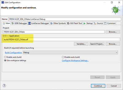

ErichStyger
Specialist I
Check that you have selected in your launch configuration the correct binary:
