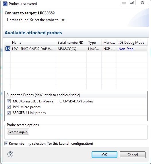

When you connect the probe, MCUXpresso IDE only detects the valid interface you are currently using. from your screenshot, you are using LPC-Link2 CMSIS-DAP , thus only this interface is shown in the "Probe Discover" window.

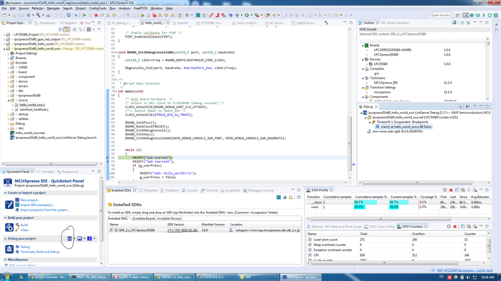

I am really confused... I loaded to MCUXpresso IDE the hello_world_swo demo code (current SDK version 2.7.1 , 322 2020-02-24) and after running debug mode (with Link Sever Proble) i was succesfully run SWO feature.
1.Is this wrong? Shouldn't this work?
2.Can i use this example to profile my own code?
3. Whats the difference with MDK or IAR?
4.  Is SWO supporting other frequencies than 12MHz?
5. After running Debug this window is shown. I was expecting to see 3 Available probes (SEGGER and P&E also). Why am i seeing only LinkServer? Am i missing something associated with LPCSrypt?

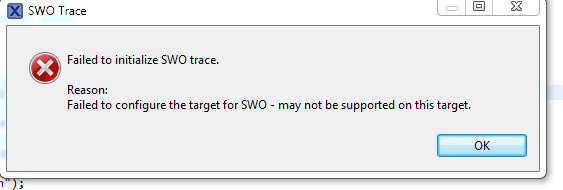

So i am facing an error (i am beginner so probably have misunderstood something) , i am building a simple hello world project with MCUXpresso IDE and after connecting the LPCXpresso55S69 i am running Debug mode. And in one Breakpoint in SW Profile i "enable Profile" and this error occurs:
What am i missing? Is this maybe related with the Debug Probe mode i have ?

ZhangJennie
I suggest you refer this discussion which could help you
https://community.nxp.com/message/1197737
Have a nice day,
Jun Zhang
