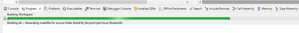

I've created a new project for IMXRT1166 (M7 core) using MCXpresso 11.6.0 wizard
SDK version is 2.12.0
When I start the build of my project I have to wait about a minute to generate make file for every folder of the source files. After that gcc compilation starts
This occurs even if I have no change in the files and in this case compilation is very fast but I have to wait for generating makefile anyway
This implies a huge waste of time for every compilation or debug cycle
I attach an image of what I see in Console View during this annoying phase
Thanks in advance

This is a known issue/behavior when having the Managed Build System enabled. I've seen along the time several issues logged against CDT with similar description. One example I quickly found is [1].
You could adapt some settings, depending on what you want to accomplish. You can explicitly disable auto-build inside launch configurations and make sure to manually build the project, when needed. You also have the option to disable Makefile generation inside build configurations, but this is risky from a development perspective if your project relies on this - you'll have to manually reenable when source files are added and you won't be able to change any build attribute.
Unfortunately, there's not much what we can do on MCUXpresso IDE side. The slowdown is generated by CDT's Managed Build System implementation and reworking it at this point is not feasible.

In Console there is no log during this phase. It hangs and you can see makefile generation for every folder in Progress tab
I Confirm that "Refresh Policy" is correctly set

I generated a sample project with the same wizard and I attach it here
With respect to the original project this has been hugely reduced and the impact of makefile generation is 20 seconds in my machine (60 seconds in the original one)
If you compile two times without changing source files the second time 20 seconds are spent to regenerate makefiles. After that gcc compilation is immediate because no change occurred
