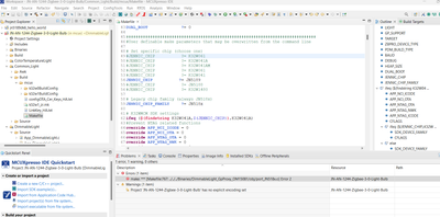

Now I have another problem when trying to build:
You see in the "Project Explorer" that the MCU is chip JN5189. But when you look at the "Problems" tab in the middel/under you see that the used SDKpackage for this project is K32W061. But I have the JN5189DK6 package.
Therefore I edited the Makefile and selected the correct chip.
Another try to build gives me an Error 2. Look at the Screenshot below in the "Problems" tab middle/under.
What do you suggest to do now? I've added the the Build Log as an attachment.

Nobody knows why the file "/Binaries/DimmableLight_NtagIcode_GpCombo_Ota_OM15081/obj/port_JN518x.d" is not in the map?

Note that the first screenshot the PATH is associated to a build configuration ("ExtendedColorLight...") whereas the "missing" PATH from the other screenshots are associated to other build configuration ("DimmableLight..."). Also pay attention to the build configuration that is being built.
