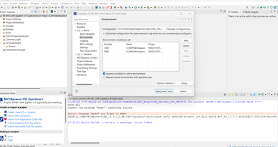

Goodday,
MCUXpresso 11.9.0_2144 gives an error when trying to build.
It gives me:
Error: Program "make" not found in PATH
PATH=[C:/NXP/MCUXpressoIDE_11.9.0_2144/ide//plugins/org.eclipse.ju.........etc
I see the double forward slash after "ide" and before "plugins".
I think thats my problem, but I cannot find the right place to edit this path.

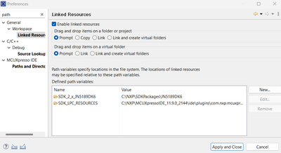

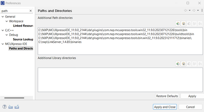

Here the path is right:
And here is okey:
And here the path is also correct.
Where must I edit this line?

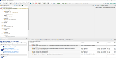

9,860 Views
Larz
@EdwinHz
I manualy enter the PATH in project -> properties -> C/C++ Build -> Environment. That seems to help because the first error is gone.
Now I have another problem when trying to build:

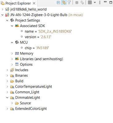

You see in the "Project Explorer" that the MCU is chip JN5189. But when you look at the "Problems" tab in the middel/under you see that the used SDKpackage for this project is K32W061. But I have the JN5189DK6 package.
Therefore I edited the Makefile and selected the correct chip.
Another try to build gives me an Error 2. Look at the Screenshot below in the "Problems" tab middle/under.
What do you suggest to do now? I've added the the Build Log as an attachment.

Larz
Nobody knows why the file "/Binaries/DimmableLight_NtagIcode_GpCombo_Ota_OM15081/obj/port_JN518x.d" is not in the map?

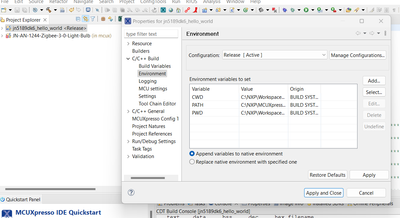

Larz
@EdwinHz Thank you for your reply.
When I import the Blink example SDK, the Path stays in the environment:
With a clean import of JN-AN-1244 the path is oke. But when I try building it gives me the error and the path is gone:

Larz
@EdwinHz
Hai Edwin,Thank you for the reply.

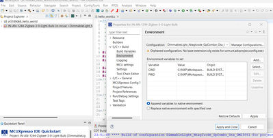

The craziest thing happened. I imported JN-AN-1244, and checked the properties:
The path is there. Than I press "build" and I get the error. But then when I look at the properties:
The path is gone?!?!?

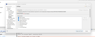

Could it have something to do with the settings Binary Parsers? I'm on a windows machine by the way...
And I checked the correct ones?

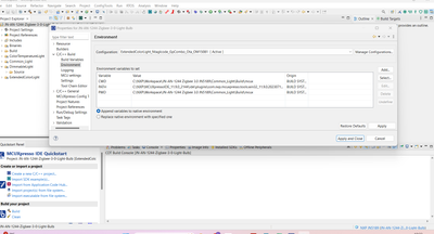

AdrianOltean
Note that the first screenshot the PATH is associated to a build configuration ("ExtendedColorLight...") whereas the "missing" PATH from the other screenshots are associated to other build configuration ("DimmableLight..."). Also pay attention to the build configuration that is being built.
Adrian

EdwinHz
Hi @Larz,
Do you see this issue in every project you try to build or have you only tried one? For single projects, the path under "C/C++ Build" > "Environment" > "PATH", as such:
You could also check here, but to open this you have to select project properties rather than IDE properties.
