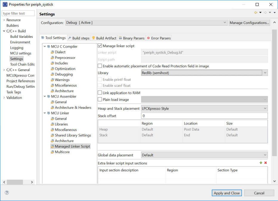

I have two LPC-Link2 boards; one as the debugger and one as the target.
MCUXpresso IDE v10.2.0 [Build 759] [2018-05-15] .
Thanks to the NXP community I now have Fast GPIO (100MHz) and HSADC (80Msps).
I now also have a massive array full of data which I want to output to a format I can use to evaluate it.
As yet I've not managed to get data output to the Debug Console and need some help getting it running.
I went back a step and started with the periph_systick example.
Set the library as Redlib semihost (in Settings->MCU Linker->Managed Linker Script)
Added the following to the code and run.
 DEBUGINIT();
 DEBUGOUT("talk\r\n");
 printf("talk\r\n");
The Debugger Console output has some information regarding the status of the debug but none of the 'user' output data.

What obvious thing have I missed this time?

So I have just gone through the process as follows:
  • Imported the projects "lpc_board_nxp_lpclink2_4370", "lpc_chip_43xx" and "periph_blinky" from the LPCOpen package provided inside the IDE's Examples subdirectory (lpcopen_2_12_lpcxpresso_nxp_lpclink2_4370_g.zip).
  • Modifed systick.c inside the "periph_blinky" project to add a "hello world" printf call after the call to Board_Init()
  • Used the Quick Settings menu on the Quickstart Panel to change the "periph_blinky" to use the Redlib (semihost-mb-nf) library.
  • In the "lpc_board_nxp_lpclink2_4370" project, I then modified board.c to simply comment out the include of retarget.h (which is sufficient to stop the redirecting of printf output to the UART).
Then after doing a full clean build of the projects, I get semihosted printf output when debugging "periph_blinky"

simon_prentice
Thank you!
I started with a new/empty workspace folder, followed your instructions and everything worked.
Not sure if my problem is due to starting with lpcopen_3_02_lpcxpresso_link2_4370.zip or if the projects were not being cleaned sufficiently.
Just one more thing, when I don't comment out "retarget.h" where is the UART output on the LPC-Link2 board?

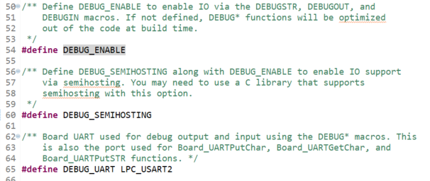

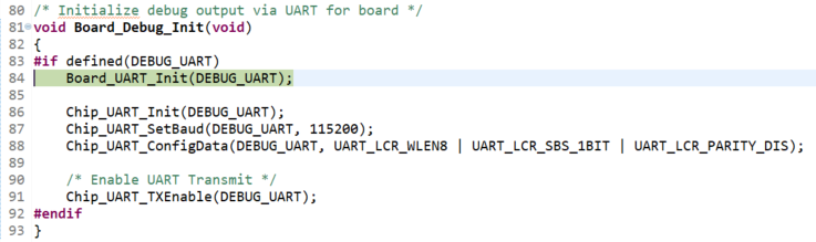

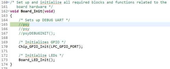

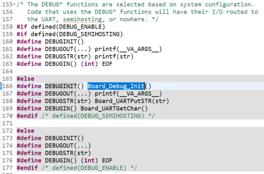

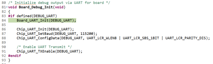

simon_prentice
Hi, That's a fair suggestion.
I made a change to board.c to remove the call to DEBUGINIT(), then cleaned ALL projects and rebuilt periph_systick.
Stepping through the code although the code view is correct it is still running against old code.
You can see it in the images below as it has hit a line of code I've removed.
Even though its commented out, it hits DEBUGINIT() and therefore Board_Debug_Init().
Are there other project files which require deleting outside of "clean"?
4,146 Views
lpcxpresso_supp

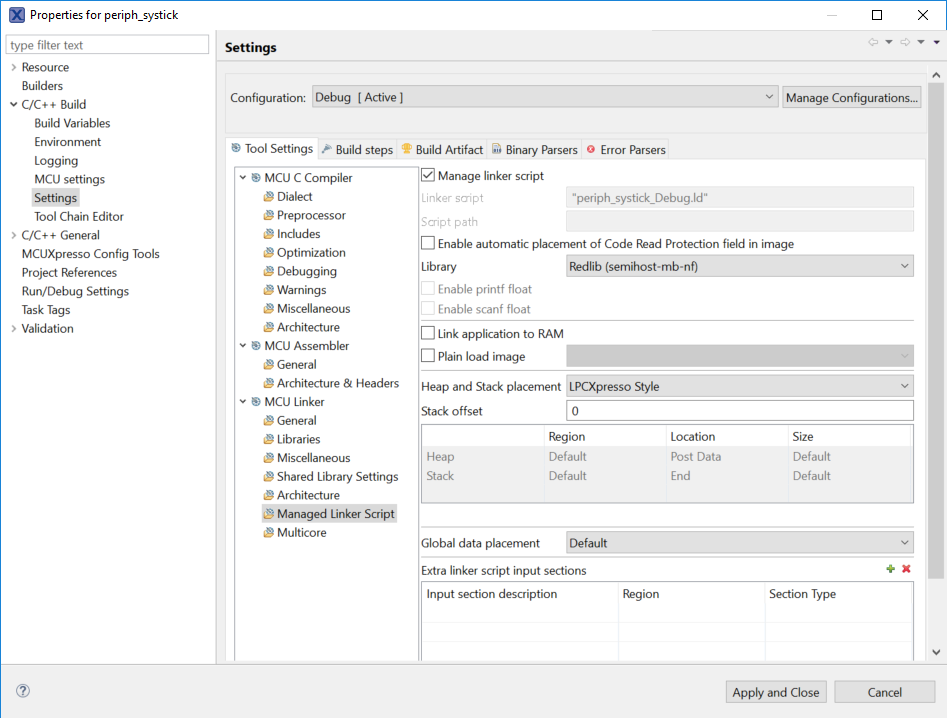

By default, your LPCOpen board library will probably be redirecting printf to UART. For details of how to change this, see section 15.5.4, "Printf when using LPCOpen", of the MCUXpresso IDE v10.2 User Guide.
In addition, if you are going to output a large amount of data, you might also want to use the Semihost-mb-nf variant of the library in order to increase the output speed.
MCUXpresso IDE Support
4,146 Views
simon_prentice
Hi, Thank you for the recommendation.
I've gone to the manual as you suggested and have set the following (shown below).
Sadly I still get no Debugger Console output
Managed Linker Script -> semihost-mb-nf variant selected
board.h -> DEBUG_SEMIHOSTING defined
board.c -> retarget.h include reference left in
When stepping through the Board_Init()->DEBUGINIT() code
it still hits the UART initialisation in Board_Debug_Init()
which surprises me as it looks like this should not be called.
