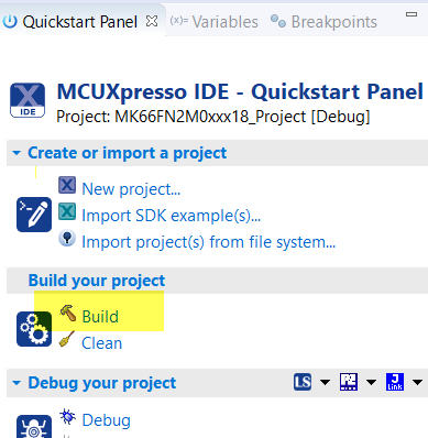

Hello Francesco Bianchini ,
- How about clean the project through " Right click your project" -> Clean project :
then build it again by click "Build" button under "Quickstart Panel":
- If still can't work, add some code in your project, build .
- If still can't work , how bout SDK demo ?
- You can also show the steps you create new project, and send your new project to me.
Hope it helps,
TIC

biafra
Senior Contributor I
Hi Alice_Yang‌,
I've tried your suggestions.
- Project clean, then build: didn't work :smileysad:
- Add code, then build: didn't work :smileysad:
- Import SDK example, then build: worked :smileyhappy:
- Create new project, then build: worked :smileyconfused:
Then I remembered: in the preceeding project I moved sources outside working directory and then I imported them again as directory link. This operation excluded all sources from build.
After the correct settings, now the project can be built.
Many thanks
Biafra
