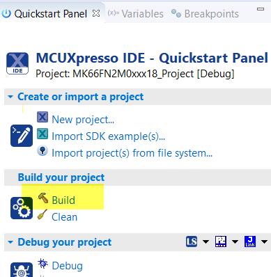

Hello Francesco Bianchini ,
- How about clean the project through " Right click your project" -> Clean project :
then build it again by click "Build" button under "Quickstart Panel":
- If still can't work, add some code in your project, build .
- If still can't work , how bout SDK demo ?
- You can also show the steps you create new project, and send your new project to me.

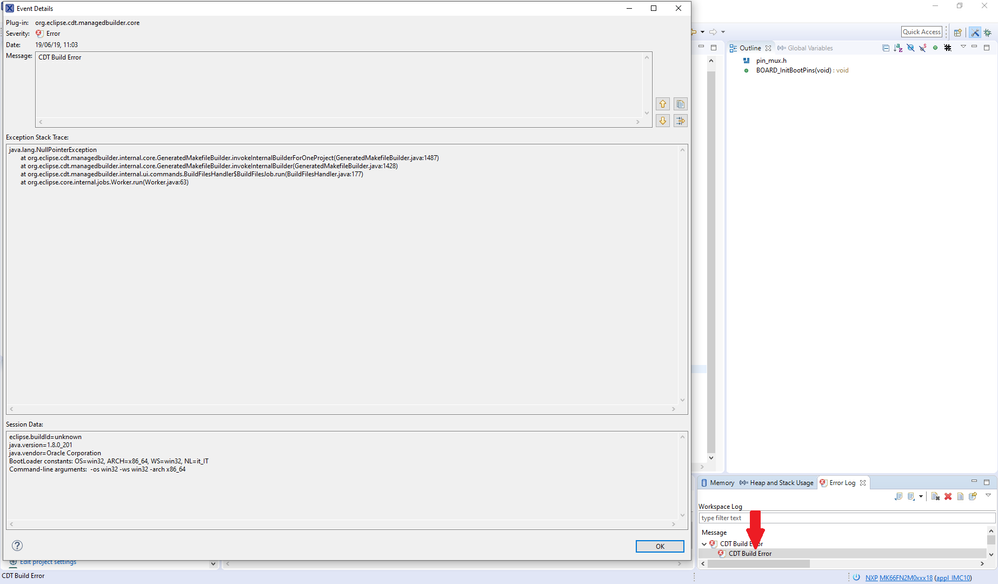

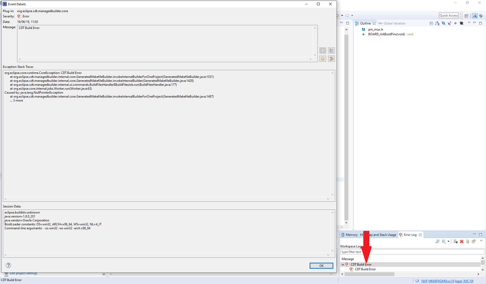

biafra
Senior Contributor I
Hi everyone,
I have some news.
If I select a c file (it doesn't matter which one) and try to build it (through Build Selected File(s) option), I get this error in the Error Log view:

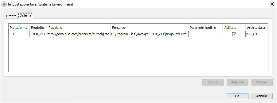

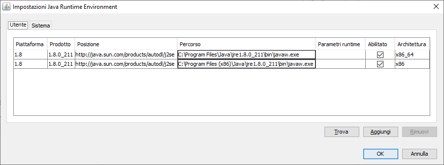

The strange thing is that the message says that the java version is 1.8.0_201, but in my system there is the version 1.8.0_211 installed:
Is there some installation problems?
Many thanks
