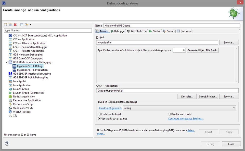

I just upgraded the other day and created new debug configurations but the 'debug' button is grayed out.  The only way I'm able to launch a debug session initially is through the blue debug button on the quick start menu.  How do I launch a specific debug configuration?

I've not managed to replicate the situation where creating new (additional to the standard Debug/Release) launch configurations gives you  a grey-out Debug button in the Launch Configuration editor.
I can think of a couple of possible ways you might be able to "workaround" this though...
Firstly, in the "Common" tab for your launch configuration, change the "Save as" setting from "Local file" to "Shared file". Which will cause it to be placed into the project. You should then be able to see your bespoke launch config in the Project Explorer view, right click on it and select the "Debug as..." entry to launch your bespoke debug session.
Secondly, again in the "Common" tab when editing your bespoke launch configuration, tick the "Display in favorites menu" option to place it in the Debug favorites. Then if you use the dropdown arrow on the "Eclipse standard" green Debug button on the toolbar, you should be able to select and launch your bespoke debug configuration.

See my response in the other thread.  This morning, no debug configurations were working at all.

And aside from that, just now it's not even working:
The green debug button is working.  The blue one gives me the 'Debug MCUXpresso project is currently disabled' error, and the one in the quickstart panel is disabled.

Further observations - I have three build configurations for one project (two for hardware variations and one for a white label version) and none of them were giving me a debug button.  On #3, I could click 'search project' and the other two binaries would show up, but not the active one.  I double checked and the binary was there.  Selecting it from the 'browse' button still wouldn't let me run it.
Just now, I switched to configuration #2 and rebuilt it and was able to launch it.  After that I switched back to #3 and suddenly it can find the binary and everything seems OK, despite nothing having changed in #3.  It seems like maybe something is wonky in the logic MCUX uses to check which configurations are up to date.  Even then, it ought to at least let you launch and build.
