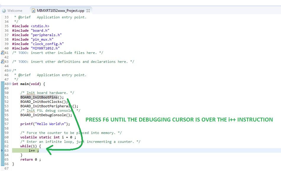

[A] Test A - Using the onboard debug interface ( USB cable )
1)  Start debugging
2)  Press F6 until the debug cursor is over the i++ instruction.

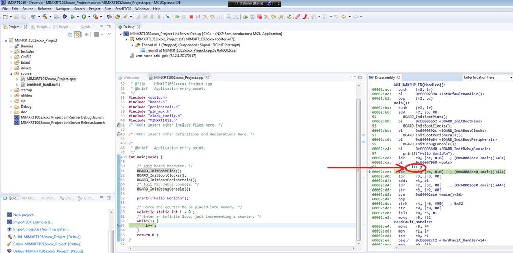

3) Now press F6 several times until the green line ( debugging cursor ) disappears.
WHY THE DEBUGGER DOESN'T STOP ON THIS INSTRUCTION ?
4) Look at the debugging led on the evaluation board .... it's blinking ...endlessy!
5) The disassembly window shows that the i++ instruction hasn't been optimized everything should work properly!!!
If you force a breakpoint in the while loop the cursor reappears and the debugging is restored!
WHY THE DEBBUGGER DOESN'T STOP ON THIS INSTRUCTION AND SEEMS TO FREELY RUN ?

Single stepping a very tight source loop like this can sometimes "confuse" GDB as you are effectively setting a breakpoint on the source line that you are already on, where you are already at a breakpoint from the previous step (depending on compiler and debugger versions, as well as options being used).
Typically if this happens, just press the "Suspend" button to pause again.
Alternatively, if you click on the i-> button in the Debug View to turn on "instruction stepping mode" you will then step at the instruction level rather than the source level, which will avoid the issue.
You could also avoid the issue by adding a __NOP(); operation after the i++ statement inside the loop.
