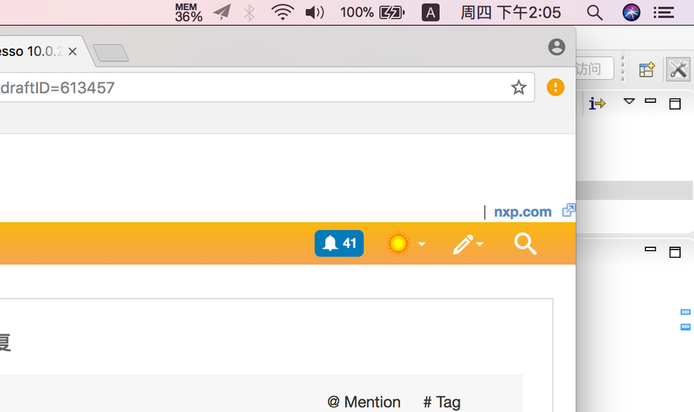

Hi All,
I am also have the same problem with MCUXpresso on MACOS high sierra, i believe the supporter's information is right after checked the stackoverflow.com. Hope MCUXpresso use newest Eclipse platform asap.
My computer is MACBOOK PRO 13' 2016, 8+512 configuration. The MCUXpresso crashed at any time, when edit the code, enter or debugging and find a link tool also crashed. Almost 90% will be crash.
A solution for me now is use Dr.Cleaner empty your RAM before debug or edit code. This will decrease the crash times.
Another way is modify the ram size in mcuxpressoide.ini, this file locate at "Applications/MCUXpressoIDE_10.1.0_589/ide/MCUXpressoIDE.app/Contents/MacOS"
Use "sudo vim mcuxpressoide.ini " and let the -Xms as "512m" and -Xmx as "2048m" maybe help. Not sure, you may try.
-Xms512m
-Xmx2048m
Btw, Dr.Cleaner is free and make sure the memory is under 40% like below pictures(MEM 36% here). This is really helpful for me. I will buy a MACBOOK with 16GB RAM or more next time.
Thank you!

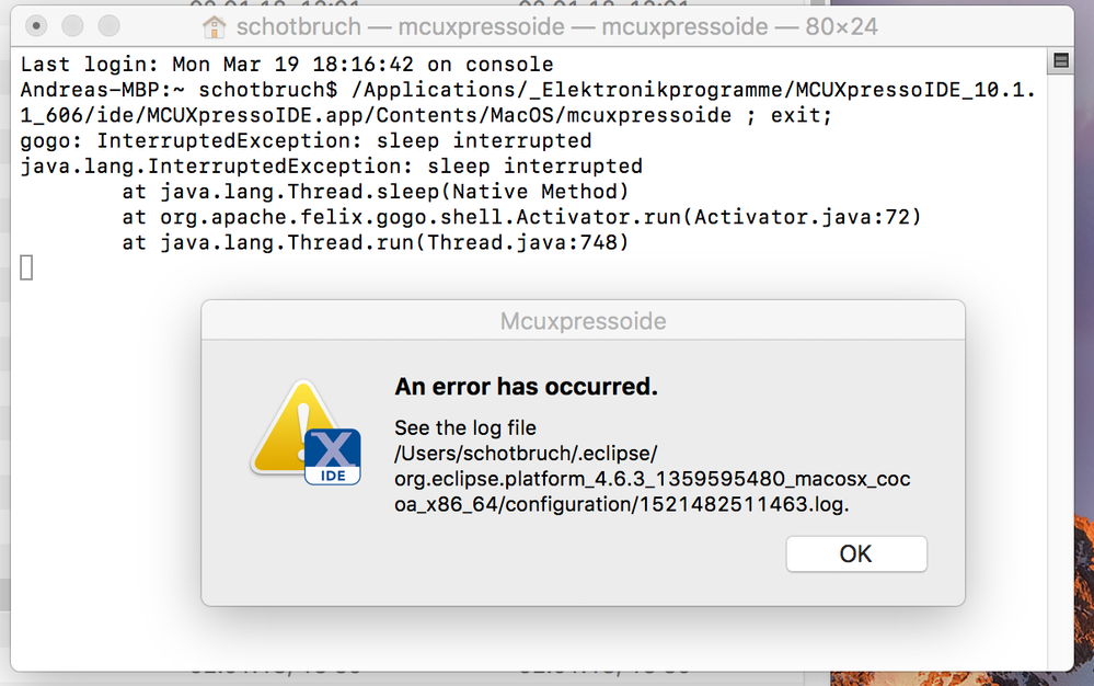

I tried this with MCUXpresso V. 10.1.1_606 and received right in the start process of the IDE attached error message. Same after restarting the computer. (Mac OS 10.13.3) What happened, what can I do?
I could not find the quoted log file. What does the . before "eclipse" mean?
happy programming and thanks for advice ...
Andreas
