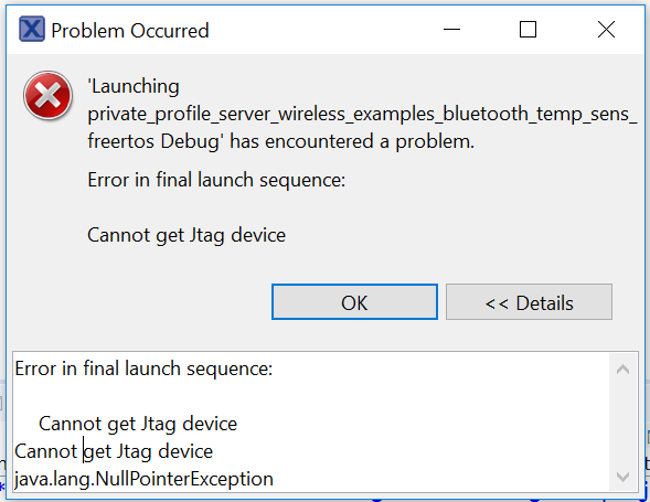

i am debugging KW36 demo code with MCUXPRESSO , when i create a new project, it always report below error, my customer also feedback they have this problems. i also noticed there are many user feedback same issue, i tried the methods in those post, but no one does work.
attached file is source code of my project, the kw36 sdk version is 2.2.0. need great support.

Also, did you flashed some example with low power functionality before? Are you sure that your device it's not going to low power?
I also experienced something similar, but it would seem to be with certain build options as I built the SDK with all the IDE's.
Nonetheless, if you will use it with MCUXpresso, have you tried downloading the SDK just for the MCUXpresso IDE? I was able to run and debug the examples building the SDK for that single IDE. I'll keep looking for the other behavior, still could you please try this ?
Hope it helps
