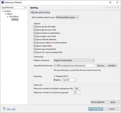

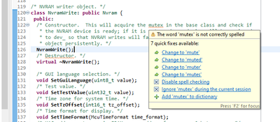

Went through the usual spots in my Eclipse preferences to set code style, code templates, naming conventions, hotkeys, editor margin, etc.  Also set my custom user directory.  Opened one of my source files, and it's flagged with many typos... except 95% of them already appear in my dictionary.

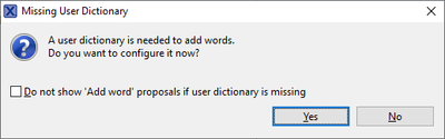

OK, I'll play along.  So I click "Add 'mutex' to dictionary".  And I get this:
Uhhh... I know I configured it already.  So I click Yes...
And there it is, my dictionary is already configured.  Closing the project, restarting MCUX, reopening the project, and reopening the source file doesn't do anything.  I can lather, rinse, repeat on hovering over a "misspelled" word, clicking "Add to dictionary", then clicking Yes to "configure it now" as many times as I like.

Thank you, that was the precise issue, selecting "C/C++ Spelling Engine".  Why in the heck getting pulled into that dialog doesn't automatically pick that option from the pulldown box is beyond me.  Longstanding bug indeed.  Thanks!
