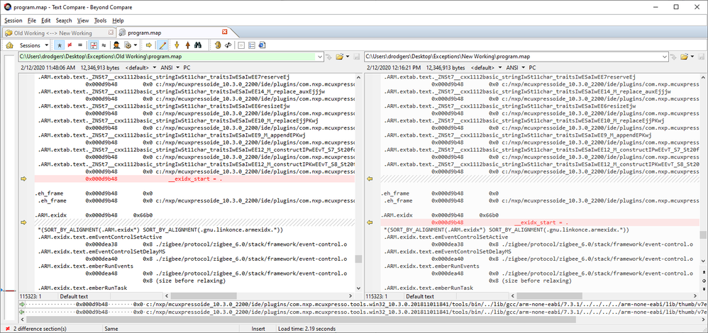

I've got your smoking gun.
So I pulled a fresh copy of my project out of the repo, and reset the linker script template to its original ("Old") version.  I then performed two builds, a functional ("Working") build, and a non-functional ("Broken") build.  The only difference between the two is that DoNothing() is called in the Broken build, and is commented out in the Working build.  (In previous code revisions, the situation would be reversed, where the functional build calls DoNothing(), while a non-functional build does not.)
Then I changed the linker script template to the fixed ("New") version, and repeated the functional ("Working") and was-previously-non-functional ("Not-Broken") builds.  Then I compared the MAP files, and the defect becomes obvious.  Let's look at the "Working" builds first, with the old and new linker scripts.
What you see here is the net effect of moving the __exidx_start/end tags inside the .ARM.exidx section declaration.  Previously, the __exidx_start symbol landed outside the .ARM.exidx section, just before the .eh_frame declaration.  With the new linker file, the __exidx_start symbol is placed inside the section, immediately after the start, where it should be.  The reason this configuration works, is that __exidx_start and .ARM.exidx have the same value (0x000d9b48), so __exidx_start does indeed point to the start of the section.
Now let's look at the "Broken" builds, with the old and new linker scripts.
The defect should now become apparent.  With the old script, the label __exidx_start is placed immediately following the preceding text, which is at 0x000d9b24.  However, .ARM.exidx entries must be 8-byte aligned, and so the symbol .ARM.exidx is moved to 0x000d9b28.  Thus, __exidx_start no longer points to the actual start of .ARM.exidx, and any exception thrown will become uncatchable.  The new linker script fixes this by ensuring that __exidx_start is declared after the .ARM.exidx symbol is declared, i.e. inside the section.  With the new linker script, __exidx_start now has a value of 0x000d9b28, the same as .ARM.exidx, and exceptions work normally.
I've attached the snippets of the MAP files should you want to examine them.  Seems pretty clear-cut, this fix needs to be applied.  Might want to examine the rest of your linker scripts as well to make sure that similar issues don't exist elsewhere.
