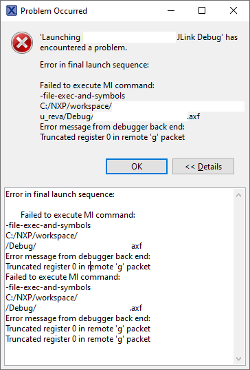

Subject basically says it all.  I'm using a SEGGER J-Link Pro on a custom RT1052 board (though I've also had this happen when connected with the J-Link to my RT1052 EVKB).  My target has been freshly reset, and MCUX has either been running for a little bit, or has been freshly restarted (I've had both fail on me).  I click the green bug to start my debug session, the SEGGER flash window comes up, compares the contents, they match so there's no programming to do, the IDE starts going through its usual "initializing the debug session" mechanics, then this error dialog pops up:
Error in final launch sequence:
Failed to execute MI command:
-file-exec-and-symbols C:/NXP/workspace/[redacted]/Debug/[redacted].axf
Error message from debugger back end:
Truncated register 0 in remote 'g' packet
Truncated register 0 in remote 'g' packet‍‍‍‍‍‍‍‍‍‍‍

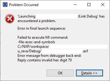

Or hey, after deleting my breakpoints and trying again, I get a different message:
Reply contains invalid hex digit 79
Reply contains invalid hex digit 79‍‍‍‍‍‍‍‍‍‍‍

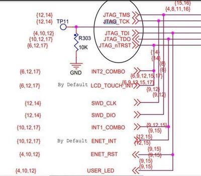

Can you check if your "target interface" is set as SWD or JTAG?
On our side, with SWD is normally working.
On JTAG, JTAG pins are connected as well to other signals that can have an impact on this functionality - so maybe it might explain the behavior:
