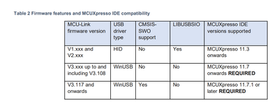

mkraft
Yes, I'm running Windows 7.
I have 11.1.1 and work with LPCLink 2. I want to be able to use the MCULink probe as the LPCLInk2 is just about obsolete.
I cannot get the MCULink probe to be discovered. I installed MCUXpresso 11.4 to see if I could get this probe to work. The probe is not found.
I did download the MCULink installer and successfully updated the firmware and I do see the device in Windows device Manager. Also under Devices as MCU-LINK CMSIS-DAP V3.108.
Is this probe not compatible with Win 7? Is there different firmware for IDE 11.4 and earlier?

Hello @mkraft
1)  Check Table 2 to confirm compatibility with the MCUXpresso IDE version you are using.
About update firmware, refer to UM:
https://www.nxp.com.cn/docs/en/user-manual/UM11931.pdf
2) About computer requirements for IDE, you can check MCUXpresso IDE Installation Guider for each version.

mkraft
Where is access to earlier versions of the MCU-Link firmware?
Thank you
