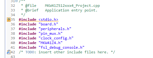

I thought to change my earlier choice of a Correct Answer, as whilst it did solve a particular case, and is the correct way to manually add new includes into a project,  it actually did not solve the problem related to those two missing links as I found another scenario that is related.
This case is rather strange and it took a good while to figure out.
If I create a new project with say an FRDM-KL25Z board or others and then create a new project with an FRDM-KW41Z board then all includes for all project are resolved and everything links ok.
If I then exit from MCUXpresso and then reopen the IDE and go to say my new FRDM-KW41Z project or any of the other projects I had created) it shows the following (links are now missing):
To confirm this, I can then choose Project... C/C++ Index... Search for Unresolved Includes, and this menu option will then pick up <stdio.h> for you.
This occurs for both c and c++ projects.

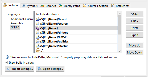

gerrikoio
An update...
I decided to pay attention to the message that's given below the includes box "Using relative paths is ambiguous and not recommended (my comment - then why provide this as default!!). It can cause unexpected effects."
I then had to manually change all include directories by ticking the "Is a workspace path".
I noticed a difference between some examples I've worked through. When I simply tick that option it inserts the actual path directory name.
However many other working demos use this macro/shortcut function "/${ProjName}" and then when clicking that option the "/${ProjName}" is always used, as follows:
I noted that there is now a new message given "Preprocessor Include Paths...."
This worked (I think) as even though my build occasionally failed I did not lose those other two links.
HOWEVER...
I then decided to change the project name (using the rename option) for my project.
When I did that I lost those two links again.

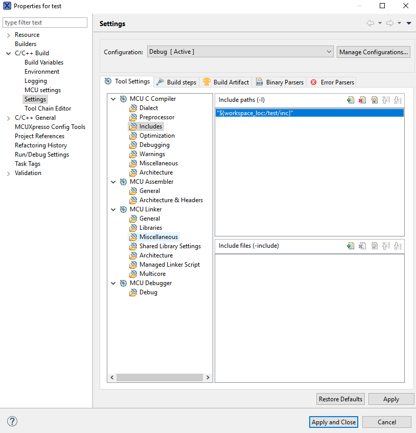

I have used MCUXpresso and its predecessors for nearly 10 years, and I have NEVER used that particular setting for include paths (as far as I know, it is 'discovered' by the IDE when doing a build - that is output by the compiler). The correct way to specify include paths is to add them in the MCU C Compiler, "Includes" section of the project properties. See image.

gerrikoio
Ah, ok. Now that solves my problem. Brilliant. Thanks for the tip, most helpful.
