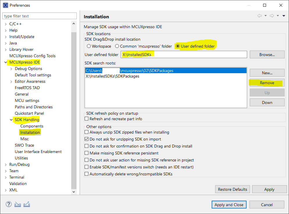

I installed the December 10, 2019 version (11.1.0_3209) of the MCUXpresso IDE over the previous version. I have some issues with it:
1. My documents folder is in drive D, as my drive C is a fast and small SDD for boot. Still, MCUXpresso created folders in my C drive:
C:\Users\<username>\mcuxpresso\02\SDKPackages
C:\Users\<username>\Documents\MCUXpressoIDE_11.1.0_3209
The actual workspace is in my Document folder on the D drive.
- How can I clean up this mess, and make sure future versions of MCUXpresso does not write to my C drive?

First of all, from what I understand, you're reusing a workspace created with a previous MCUXpresso version. While this approach is not completely wrong, if we add to the recipe a new Eclipse version and some internal plugins refactoring, we'll end-up seeing weird problems. Long story short is that we recommend starting with a fresh workspace given the update you performed.
To answer your questions:
1. You can always specify a custom location for the SDKs installation and then remove the one that's tied to the user profile.

1. Relocating the SDK's this way worked nicely. Thank you!
  • Do I have to do this always, when I install a new MCUXpresso version?
  • It would be nicer if the SDK directory would not be automatically selected in a non-existent path, but asked, defaulting next to the workspace directory.

1. Actually, the change is linked to the workspace.
