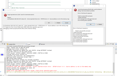

Example program compiled fine. Tried to load in to LPC5536-EVK and got flash errors:
Failed with both Linkserver and Segger J-Link
Any ideas?

Are you tied to using IDE 11.6.1? I suggest updating to the most recent version. What's the board revision and the SDK version you use?
I've also just checked on my side and there's no problem debugging the standard "hello world".
