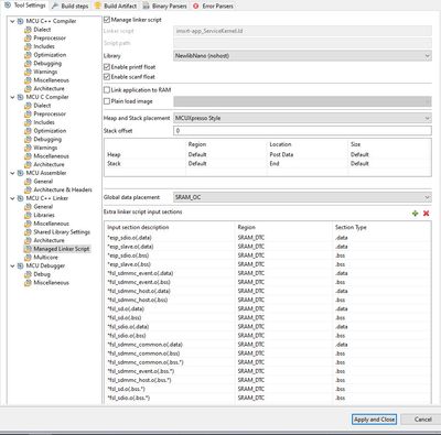

I have at least two object files whose data (.data and .bss) needs to go into SRAM_DTC, and not just their globals.  I have an app that uses USDHC.  If I build a version of this app with all data put in SRAM_DTC by default (using C/C++ Build >Settings > Linker > Managed Linker Script settings), it works perfectly.  However, if I build a version that puts all data into SRAM_OC by default, it doesn't work at all.  I think it's due to some things being accessed via DMA that need to be in DTC.  I know I can use __attribute__ section tags inside my code, but this is not helping.  I need to be able to be able to tell the linker to put an entire .o file of .data/.bss into DTC using a linker file (unless there is another way).  I tried this using the flexspi nor example as a base and modifying it thusly:

nxp16
It turns out, that it's not just my code.  The sdmmc drivers provided with the sdk do NOT work at all if you default global data placement to SRAM_OC (which I have to do because my full app uses too much ram for DTC).  I was somewhat able to get this working by adding sections to the link settings but not fully yet:
I will update here when I've figured it out fully.  I wonder if the same problem happens using SDRAM as the default?

nxp16
I also had to add fsl_usdhc.o to the list.  Now I just have problems in my own code (well, ESP32's code).  Some of this code uses "buffers" on the stack/heap (uint32_ts and such).  I just have to figure out a good way to make those end up in DTC (because the stack/heap is in OC by default).
