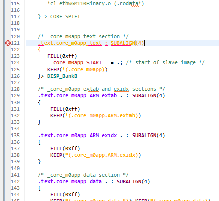

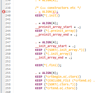

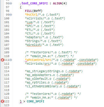

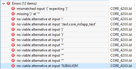

It appears that the XText nature which was added to support freemarker syntax coloring does not handle comments in the link scripts gracefully.  I have migrated several LPCXpresso projects into MCUXpresso and found several of the internally generated linker stubs (where comments already exist) are not parsed by the freemarker xtext grammar properly.  Keep in mind these are comments which already existed in the default linker templates.  I did not add them.
The actual build generates binaries, but the project remains in an error state which undoubtedly WILL affect our automated build tools which rely on the command line compiler.  What do you propose as a fix for this problem?

After further experiments, I am reasonably certain that the xText parser for LD linker scripts is not working properly.  It appears that the parser gets hung up on wildcards in path names (because the syntax contains the multi-line comment sequence "/*".  The xtext parser obviously believes I have a multi-line comment starting on Lin 99.  The parser does not recover again until line 111, and then gets thrown off into another multi-line comment which continues on until line 122.
I like the idea of making the LD scripts more readable, but if you are only going to support a subset of the LD syntax, that's a non-starter in my opinion.  I used to write xText grammars and gave up on situations like this when the grammar attempted to implement an already-existing parsed language that is not actually implemented with xText under the hood in the GNU tools (in this example, LD).  There were just too many corner cases to be able to support, and there was no way to pull some of those cases off using what existed at the time with xText.  If you are making your own language from scratch, xText works very well.  Either way, I hope you are able to fix this problem, or have a workaround you can propose for us.
I attempted to remove the XText nature from my project, but no luck.  The project still has errors even though the output executables are generated and valid.

Does this help? https://community.nxp.com/thread/527820
BTW: This is part of the Eclipse CDT project, and so you might get more help there.
4,405 Views
brich
That did the trick on my workstation.  I have yet to see if this will also work on our build server which invokes mcuxpresso (used to be lpcxpresso) from the command line.  I don't see it preserving the setting in the project file.  Thanks for the workaround!

Hi Brad,
You mean changing the editor for the .ld files?
The linker script coloring is independent of the build system (it is for the editor view only), so should not affect your build.
As for the affected .ld files: would you mind posting them here? That way the IDE engineering team could check why parsing them failed (instead trying from your screenshots).

Yes Erich, I changed the editor for the *.ld files.  That's good news about the errors not affecting builds, although it is kind of annoying to have any errors exist in the project at all when nothing is problematic to the actual toolchains.  I hope you can fix it, but after working with Xtext in the past, I have my doubts.  Hopefully they have made some improvements to the framework.
Here is my linker script:

    .text_CORE_SPIFI : ALIGN(4)
       FILL(0xff)
       *PcCtrl/*.o (.text*)
       *xCirrisOs/*.o (.text*)
       *Lua/*.o (.text*)
       *SPC/*.o (.text*)
       *ETL/*.o (.text*)
       *CTL/*.o (.text*)
       *Adapters/*.o (.text*)
       *Strings/*.o (.text*)
       *Wirelist/*.o (.text*)
       /* *TesterCore/*.o (.text*) */
       /* *emWin_M4.a:* (.text*) */
       *xPcControl/src/*.o (.rodata* .constdata*)
       *xCirrisOs/src/*.o (.rodata* .constdata*)
       *ap_strLegacyStrings.o (.rodata*)
       *ap_adpAdapters.o (.rodata*)
       *ap_wlDefault.o (.rodata*)
       *ap_rptFiles.o (.rodata*)
       *cl_ethWGM110Binary.o (.rodata*)
       /* *TesterCore/*.o (.rodata*) */
       /* *emWin_M4.a:* (.rodata*) */
    } > CORE_SPIFI
    /* _core_m0app text section */
    .text.core_m0app_text : SUBALIGN(4)
       FILL(0xff)
       __core_m0app_START__ = .; /* start of slave image */
       KEEP(*(.core_m0app))
    }> DISP_BankB

   /* *(EXCLUDE_FILE(*TesterCore/*.o) .rodata*) */
   /* *(EXCLUDE_FILE(*emWin_M4.a:*) .rodata*) */
   *(EXCLUDE_FILE(*bd_fwFirmwareMgr.o *iap_18xx_43xx.o *romapi_18xx_43xx.o *rgu_18xx_43xx.o) .rodata)
   *(EXCLUDE_FILE(*bd_fwFirmwareMgr.o *iap_18xx_43xx.o *romapi_18xx_43xx.o *rgu_18xx_43xx.o) .rodata.*)
   *(EXCLUDE_FILE(*bd_fwFirmwareMgr.o *iap_18xx_43xx.o *romapi_18xx_43xx.o *rgu_18xx_43xx.o) .constdata)
   *(EXCLUDE_FILE(*bd_fwFirmwareMgr.o *iap_18xx_43xx.o *romapi_18xx_43xx.o *rgu_18xx_43xx.o) .constdata.*)
   . = ALIGN(4);
            /* C++ constructors etc */
            . = ALIGN(4);
            KEEP(*(.init))
            . = ALIGN(4);
            __preinit_array_start = .;
            KEEP (*(.preinit_array))
            __preinit_array_end = .;
            . = ALIGN(4);
            __init_array_start = .;
            KEEP (*(SORT(.init_array.*)))
            KEEP (*(.init_array))
            __init_array_end = .;
            KEEP(*(.fini));
            . = ALIGN(4);
            KEEP (*crtbegin.o(.ctors))
            KEEP (*(EXCLUDE_FILE (*crtend.o) .ctors))
            KEEP (*(SORT(.ctors.*)))
            KEEP (*crtend.o(.ctors))
            . = ALIGN(4);
            KEEP (*crtbegin.o(.dtors))
            KEEP (*(EXCLUDE_FILE (*crtend.o) .dtors))
            KEEP (*(SORT(.dtors.*)))
            KEEP (*crtend.o(.dtors))
            . = ALIGN(4);
            /* End C++ */

Best wishes, and thanks for your help.
4,405 Views
converse
Senior Contributor V
I think the simplest way for you to do this is to use the Managed Linker script scheme to override the default template provided in the IDE. Take a copy of
noinit_section.ldt (from C:\nxp\MCUXpressoIDE_11.0.0_2516\ide\Wizards\linker) and place it in a folder in your project called linkscripts
edit this file to remove the offending "."
You should now be ale to build as you expect. For info, see Chapter 18 in the User Guide.
