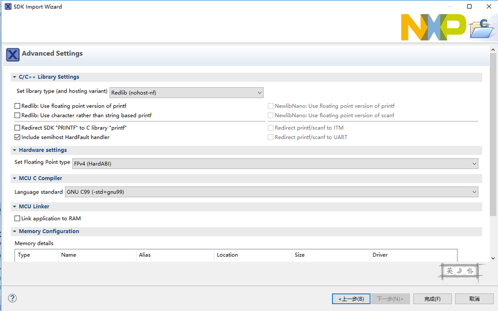

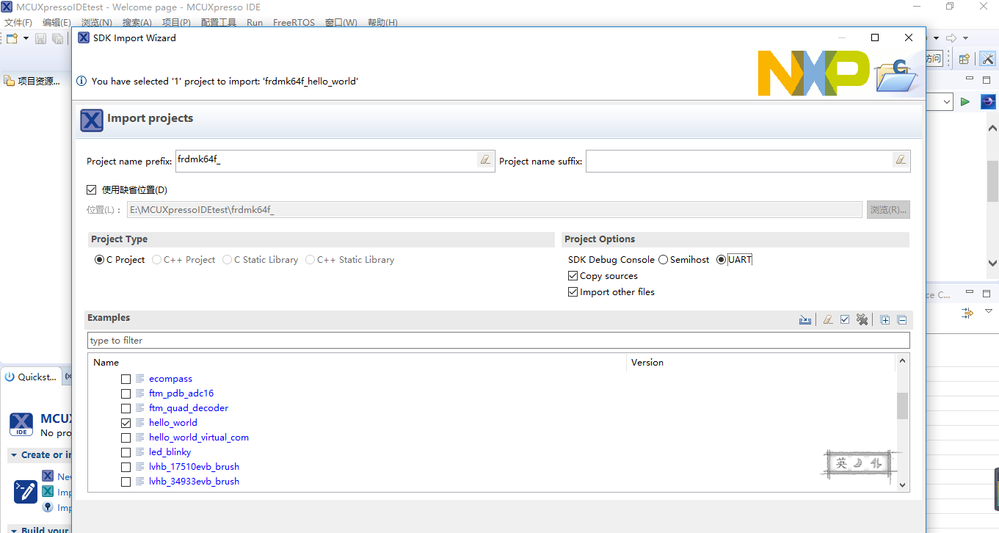

Hello! I added the DSP library according to the Moth link,Using CMSIS-DSP with MCUXpresso SDK and IDE

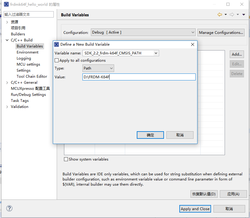

 but there was such a problem in the build variables:

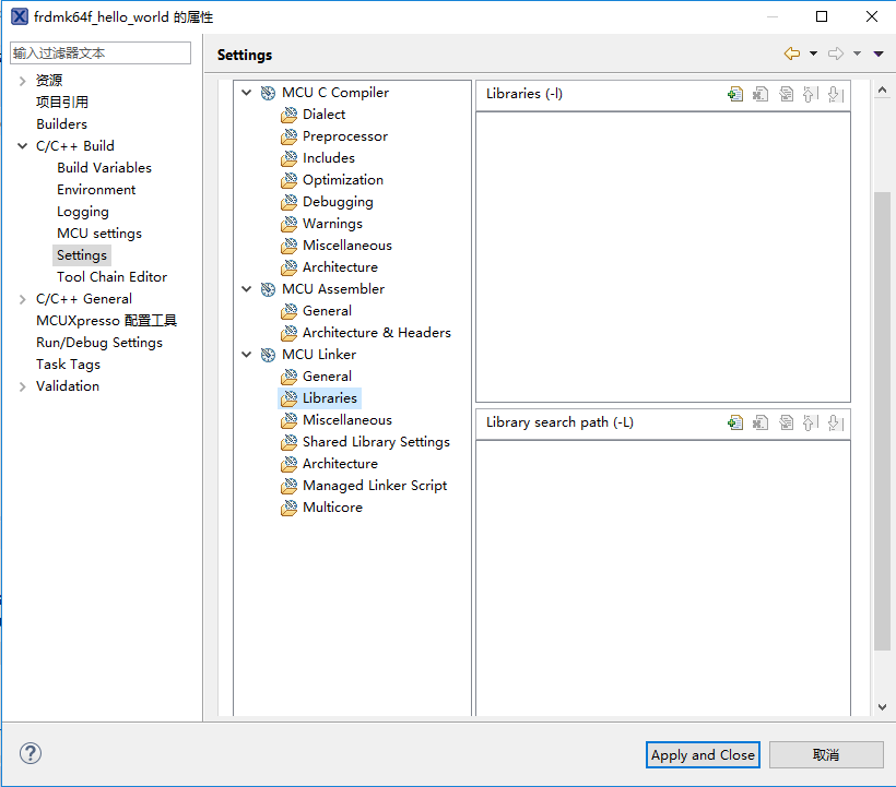

 I didn't see the result added in the previous step in the setting librarise,
and I still get an error if I manually add the following compilation.
See the figure below for details.
If I add the library manually, there will be many errors in the build.

Hello Jason William,
Yes, you need add the lib manually.
 In the "Value" of Define a new build variable, please add  C:\FRDM-K64\CMSIS .
 In the Add libraries :
Libraries(-l) :   arm_cortexM4lf_math
Library search path(-L) :   "${SDK_2.2_frdm-k64f_CMSIS_PATH }\Lib\GCC"
I test on my side , it can work well.
Hope it helps,
