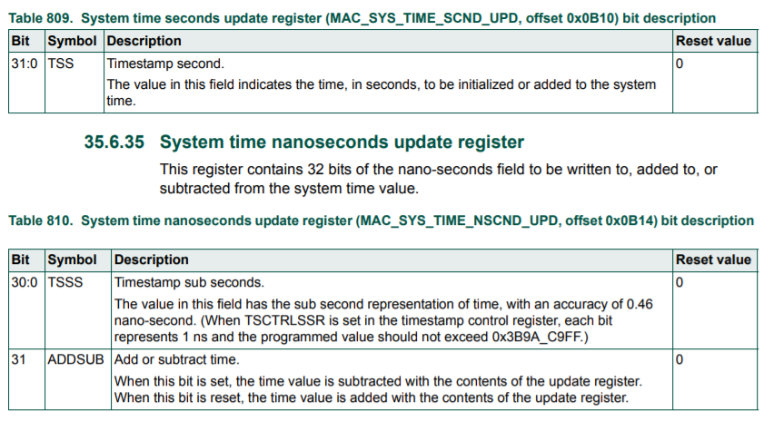

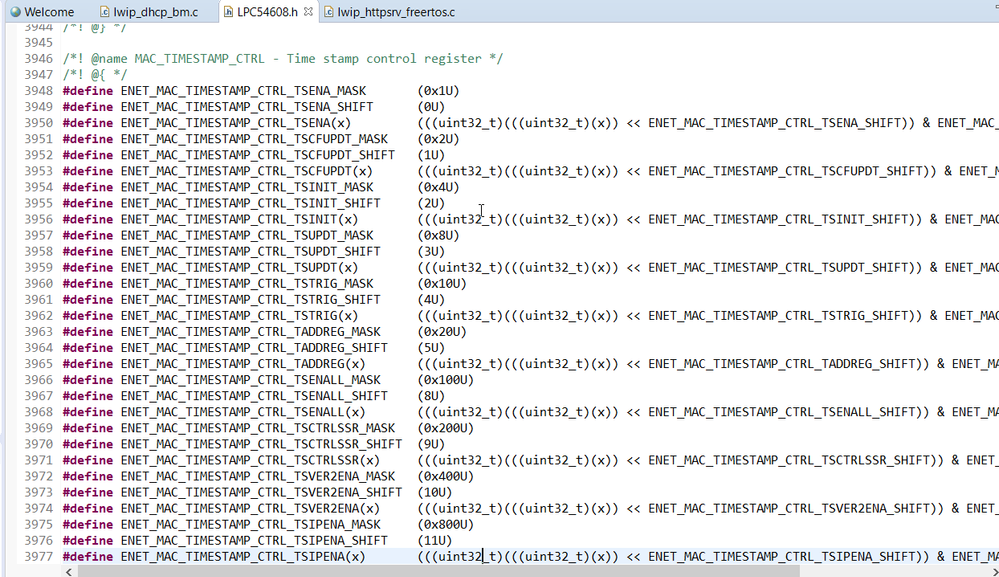

The bit TSTRIG in the MAC timestamp control register  Enable timestamp interrupt trigger.
the bit TSUPDT in the same register Update timestamp. When this bit is set, the system time is updated (added or subtracted) with the value specified in MAC system time seconds update Table 809 and MAC system time nanoseconds update Table 810. This bit should be zero before updating it. This bit is reset when the update is complete in hardware. The timestamp higher word register (if enabled during core configuration) is not updated. Access restriction applies. Setting 1 sets. Self-cleared. Setting 0 has no effect.
The lpc54608.h file contains the definitions for the Time stamp control register.

     There are 2 method described in LPC54606 manual "36.7.11.8.2 System time correction", " coarse correction method " and " fine correction method ", your reply explains " coarse correction method ", I asked " fine correction method ".
    I just do't understand the flow described in the manual.
