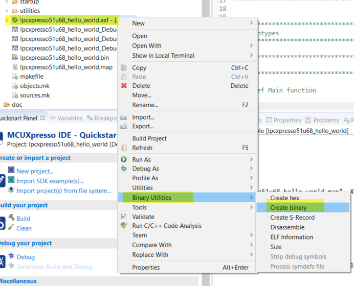

Hello Christian Grosse,
- In normal way, after copy .bin file into device, just re-power board, it can work well, I test on my side.
- "how to generate the correct bin file (from MCUXpresso IDE?)"
-> Config Debug Console to "UART console", build, then refer to the below screenshot to generate .bin file:
