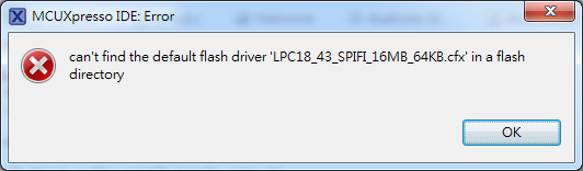

For MCUXprsso, when I want to use Flash with LPC-Link2, MCUXprsso show the configure file is loss, then I find this file in the LPCXpresso directory in my PC.

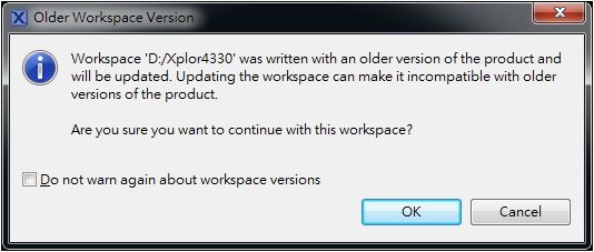

I download the lpcopen_3_01_lpcxpresso_ngx_xplorer_4330 sample code project,
When I open this workspace with MCUXpresso, it notice me that I need covert it to new project.
And I build the freertos_blinky project, and use IDE flash, it show the "Flash driver" is "LPC18_43_SPIFI_16MB_64KB.cfx".
I think it's lpcXpresso setting. And MCUXpresso can't find this cfx file.
So I browse the "LPC18_43_SPIFI_GENERIC.cfx", and it can work without any problem.

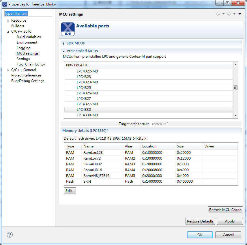

But I need to do this every time, because it seem the project will not store this setting.
I want to know if my develop environment has something wrong so that I need to do this.
I don't know how to set the flash driver because I didn't find option in my IDE(windows version).

I can confirm that the problem is that the LPCOpen example you have imported references an old flash driver that is not supplied with MCUXpresso IDE (more on this later). The GUI flash programmer always references a project within the Project Explorer and will use the flash driver specified there. To avoid having to re-select the correct flash driver, simply edit the project in project explorer and select the LPC18_43_SPIFI_GENERIC..cfx - this will then be picked up by the GUI flash programmer next time you use it.
To change a projects flash driver, right click in Project Explorer and select Properties -> C/C++ Build -> MCU setting -> Edit -> Browse to the new Default Flash Driver -> OK -> Apply -> OK
