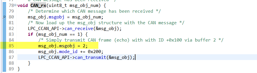

I try to set several CAN filters in my application. For some reason only the first one is taken into account. My code:
ROM **rom = (ROM **)0x1fff1ff8;
void set_filter( uint8_t can_msg_obj, uint32_t msg_filter_id, uint32_t msg_filter_mask)
    CAN_MSG_OBJ can_filter;
    can_filter.msgobj = can_msg_obj;
    can_filter.mode_id = msg_filter_id;
    can_filter.mask = msg_filter_mask;
    (*rom)->pCAND->config_rxmsgobj(&can_msg_filer);
(*rom)->pCAND->init_can(&ClkInitTable[0], 1);
(*rom)->pCAND->config_calb(&callbacks);
NVIC_EnableIRQ(CAN_IRQn);
set_filter(1, 0x100, 0x700);
set_filter(2, 0x200, 0x700);
So when I send a CAN message with ID:100 I can see that CAN_rx has called. when I send a CAN message with ID:200 nothing happens.

Hello Muhlinin Ruslan,
Sorry to reply you late, I just got my board.
After check and test your code on my side, the issue is the
the same with the code in "CAN_rx()"
Change one of them to 3 will fix the issue.
I use a CAN bus tool on PC communicate with LPC11c24 board, and take a video about on my side, please check my attachment.
Hope it helps,
TIC
3,773 Views
ruslan1
Thanks Alice_Yang, you are just genius! I really didn't pay attention to this. Your answer really helped me a lot. Thank you so much for your efforts.
