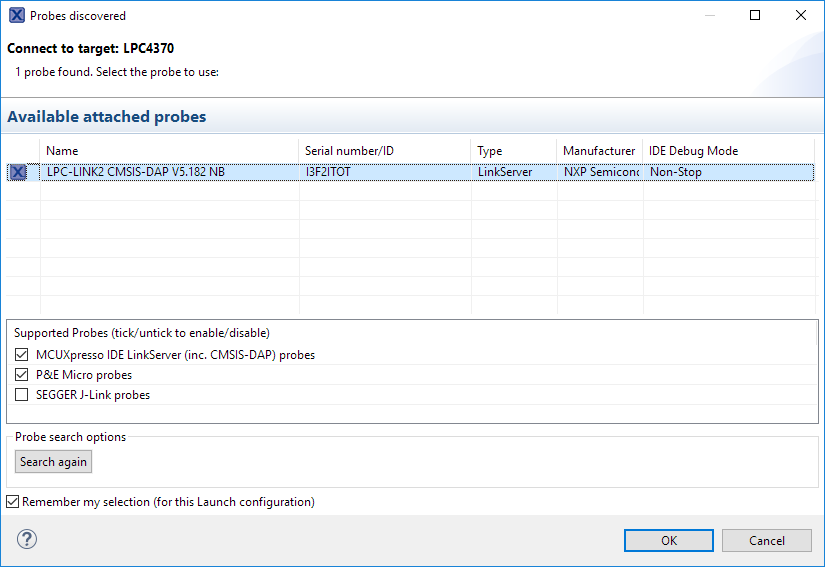

vitaliylivnov
Thanks for your answer. No, I don't have separate target board. Can I use J-Link for debugging LPC-Link2 controller? And if so, how to set it up in MCUXpresso?
6,223 Views
lpcxpresso_supp
It almost sounds like your probe hasn't booted. The MCUXpresso IDE will DFU boot the probe if it's not found. Delete your launch configurations, and power cycle your probe. Be certain no rogue redlinkserv, crt_emu_cm_redlink, or arm-none-eabi-gdb processes are running. If the probe boots successfully, the IDE will show the probe details for you to select. Let us know what you find.
Thanks and regards,
MCUXpresso Support
6,223 Views
vitaliylivnov
1. If I understand you correctly, then here is the window that appeared after all the actions done and start debugging.
2. I have Segger J-Link programmer. Can I use it for debugging of LPC-Link2 board?
