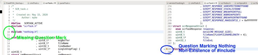

Okay, I think I figured out the problem - source files aren't being the checked the same way as include files.
For example, if I put in "#include "nothing.h" in a source file and a .h, I get the results:

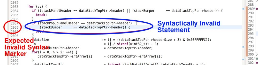

I noticed that syntax errors were no longer caught in the source editor like:
I haven't changed anything in MCUXpresso's IDE or the project preferences.
This wasn't an issue in 11.3.1.
Could you please look into this?

One more datapoint.
When I built the code in the last example (#include "nothing.h" in a .c and a .h), there is an error generated by the non-existent file in the .h file but no error in the .c.
I consider this to be a very signicant problem with the operation of MCUXpresso IDE and how the compilers work with different files types.
Sorry for adding to your workload, but these issues need to be addressed immediately.

At first sight, the indexer does not successfully parse the source file you refer to. I noted that you're modifying a relatively large source file (2k+ lines). Maybe this is what's causing the issue? Not sure if there's such a (low) limit though. Would you please try the same use case in other source files and let us know if that works as expected? Anyway, I'd also expect the same behavior in IDE v11.3.x.
You might also want to check whether the "unresolved inclusion" is not reported at all or it's just not shown in the IDE's views (Source and Problems). To do this, right-click the source file with the invalid header inclusion => Index => Create Parser Log File. Then check "Scanner problems" section.
As a side note, CDT comes with a code analysis tool (Codan) and with the Indexer. They both inject markers and they both can be controlled at workspace/project level (Window => Preferences => C/C++ => Code Analysis / Indexer, or via project's properties => C/C++ General => Code Analysis / Indexer / Paths and Symbols). Maybe check these as well.

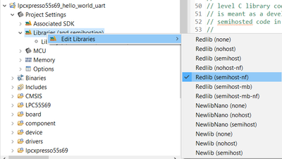

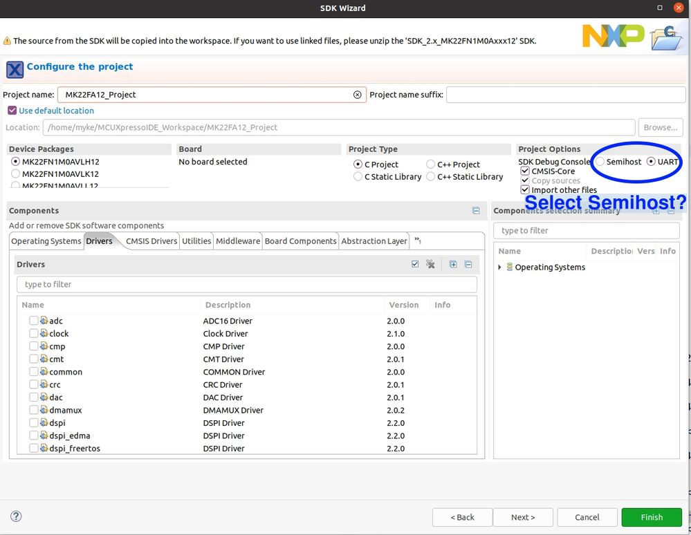

Can I ask what happened to console PRINTFs in Semihosting debugging?
I use them quite a bit for monitoring operation during development - how do I get them back?  I noticed the change in SDK_DEBUGCONSOLE default being set to 1 rather than 0, but I thought setting it to 0 would allow things to run as expected.
I know that Semihosting is out of style but I really don't want to change to another approach at this point of product development.
Thanx - hopefully there's a simple answer here.
5,376 Views
lpcxpresso_supp
The easy part first...
Decision to move from Semihosting to UART was mostly driven by some factors like consistence with other IDEs, performance and a preference towards UART coming from various directions. Sticking with Semihosting is easy - simply make sure it is selected accordingly during New / Import Project wizards. You can also make the switch by changing the runtime library and the define you mentioned.

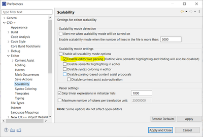

Regarding the indexer issues and the note below, was the log obtained while having the unresolved inclusion in that source file?
I did generate a log file (attached) and sections headed with "unresolved inclusion" and "scanner problems" are not present.  The source file compiles without errors or warnings.
Also, it's worth disabling the setting highlighted in the screenshot below and see if it has any effect in your situation. Please report back the result. Meanwhile, we'll try to reproduce it on our side before jumping to NDAs.

I made the Library change in the "Project Settings" and I see all my debugging information - thank you!
Now, when I create a new project, I should select "Semihost" for the "SDK Debug Console" as shown here:

I clicked off the "Disable editor live parsing" and everything appeared as expected:
I see in the box above, "Enable scalability mode when the number of lines in the file is more than: 5000" - "scrTask.c" is 5,089 lines long.  I just checked the size when I first created the project (from the previous project) and it was 5,019 lines long.
I see you have found the setting. I recommend to increase it maybe to 10k or so, as FreeRTOS task.c is above 5k too.
The other hint: this is all about the 'Indexer', so it might make sense for you to re-run it in case you think it is out of sync: there is a context menu on the project (Index > Rebuild) for this. Additionally depending on the complexity of your projects I recommend to disable the 'heurisitics', see https://mcuoneclipse.com/2012/03/20/fixing-the-eclipse-index/  and for power users: https://mcuoneclipse.com/2021/01/10/eclipse-indexer-debug-tips/

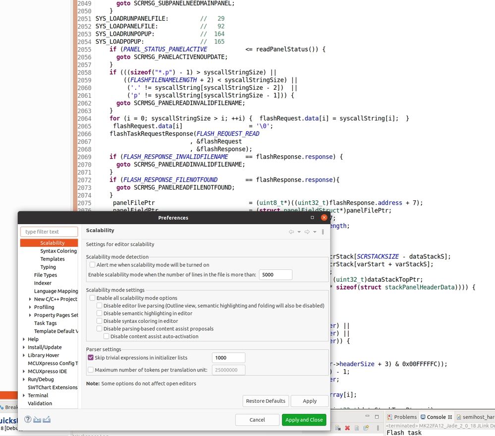

As I indicated before, I looked at the other .c files in the project and they are showing the mark ups/other colours as expected.
I took a look at the suggested preferences and couldn't see anything that jumped out at me.  As I've indicated that other .c files seem to work as expected.
Now, the "scrTask.c" file is just over 5k lines in length - I'm guessing that it is running over some kind of line limit for the automatic mark up features.  I am not able to share this file with you without an NDA in place.
What are our next steps?
5,165 Views
ErichStyger
Senior Contributor V
Hi @myke_predko ,
I apologize for jumping in here late (have been busy with preparing the new university course material).
Yes, there is a default limitation of 5k lines for the indexer in Eclipse. You might have seen my article about it here: https://mcuoneclipse.com/2020/10/31/freertos-and-eclipse-indexer-for-5k-lines-source-files/
That setting is the default workspace setting in Eclipse as long as I can think of. The reason is to avoid slowing down the background Eclipse process to parse the files. If 5k is reasonable or not can debatable. My rule of thumb is that if a source file exceeds 1k it should require refactoring. But for generated files that rule might not apply.
Anyway you could increase that setting (I usually have it at 10k) and you should be fine.
