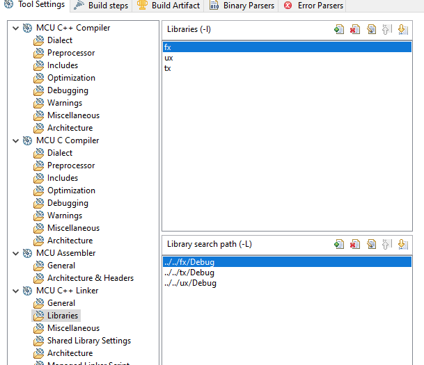

Well, that was trivial to solve. As I said yesterday
Check the ordering of your libraries if a function in library A calls a function in library B, then the ordering must be A B.
All you need to do, is re-order the libraries in the linker settings. I moved the 'tx' library to the bottom, so the order is now fx, ux, tx:
To change the order, just select the library and click the down arrow in the top right. As you can see, the ordering of the libraries is critical.

I think to help any more, we are going to need to reproduce the issue. Can you provide an example that exhibits the same problem?
10,128 Views
chadgraham
Contributor V
converse
Hopefully this works the same for you as it does for me, but here is a much trimmed down version of my project that does not compile.  It produces the same error as my main project and I left the file structure mostly the same.  (I removed includes and libraries not used by this sample.)  You may need to download the RT1060-EVK SDK, but the project is otherwise self supporting.  Please let me know if you have any issues with it.
10,129 Views
converse
Senior Contributor V
10,128 Views
chadgraham
Contributor V
converse
Thank you!  I did play around with the library order, but misunderstood the implied sequence.  I was thinking that the library B would need to be loaded first so that it was available for A.
10,124 Views
converse
A library which calls an external function defined in another library should appear before the library containing the function.
