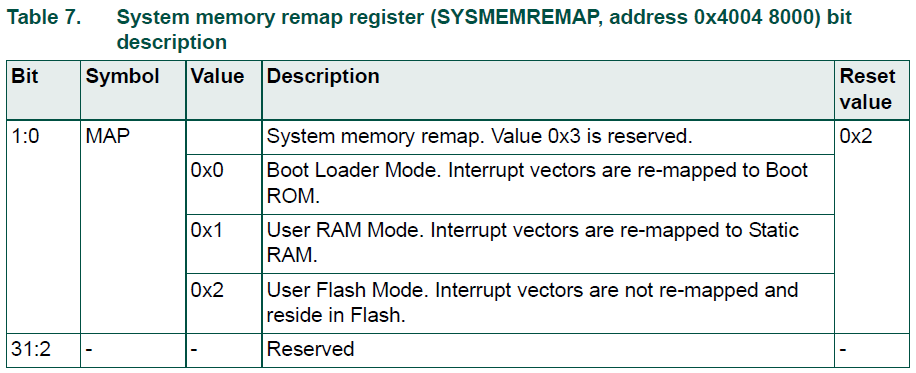

Hello!
I have been reading and scrutinizing the IAP eeprom library and found out that the interrupts has to be disabled and enabled during a read and write operation.
However, for my application, I have to enable the interrupts in order to receive other high priority interrupts, so I want to do it concurrently in the background.
Today, I can write to EEPROM but I am losing messages since I am removing the interrupts.
Here is a sample code of how I do it now:
iap_eeprom_write()
disable_int();
invoke_iap();
// enable interrupts
enable_int();
Back to the problem, is it possible to create a background interrupt handler using IAP_EEPROM and remove the disable/enable interrupt functionality?
I know that there are background callbacks that can be used to handle background operation with interrupt priorities in for example data flash reads and writes.
If not, is there any other alternative for eeprom library that can be used in order to run in the background.
I would be very glad if you could provide me with some help.
regards,
Volle

jeremyzhou
Hi Volkan Coskun,
for the opportunity to serve you.
The on-chip flash memory and EEPROM are not accessible during erase/write operations. When the user application code starts executing, the interrupt vectors from the user flash area are active. Before making any IAP call, either disable the interrupts or ensure that the user interrupt vectors are active in RAM and that the interrupt handlers reside in RAM.
The LPC11Exx has the ability to remap the interrupt vector table to the RAM by changing the MAP bits in the SYSMEMREMAP register. This allows interrupts to occur even during the erase and write operations. But as the flash cannot be accessed during this time, the interrupt handlers must be executed from the RAM. Hence, all the code related to the interrupt handlers must be copied from flash into the RAM.
TIC
