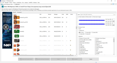

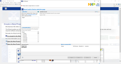

I just installed MCUXpresso a couple days ago, but I'm having some problems crating a project with the SDK of frdm-kl25z. At the SDK Installer it says it is installed but nothing shows up at the SDK wizard when I try to creat a project. Any help is appreciated.

Hi @EduardoDueñas
Please download sdk_2.2.0_frdmKL25 from  https://mcuxpresso.nxp.com/en/welcome
and drag the SDK.zip into MCUXpresso installed SDKs tab.
Then you will see the Frdm-kl25z when you create a new project.

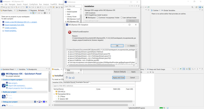

I've alredy tried that but when I try to drag the program ask for permission but nothing happens. Also, this error is showing up some times:

danielchen
Please make sure you have the 'administrator' right.
and the MCUXpresso IDE should be installed as administrator, you should have sufficient privileges.

EduardoDueñas
Hi @danielchen,
I've alredy tried runing as administrator but the same error keep occurring. I also tried restalling but the same error keep poping up. Is there any other thing I could do?
