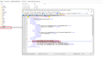

Hi. I am trying to compile a C++ project. I have included all the files in the includes list. Even then I am getting error saying tx_port.h file is neither a file or directory. I am using a GNU C++ compiler. The same application in C is compiled successfully. But using C++ compiler it is failing, What can be the reason?

I think you can import the SDK netx_duo example, and adds your code.
If you want to add C++ code, you need add <nature>org.eclipse.cdt.core.ccnature</nature> in .project.
Harry

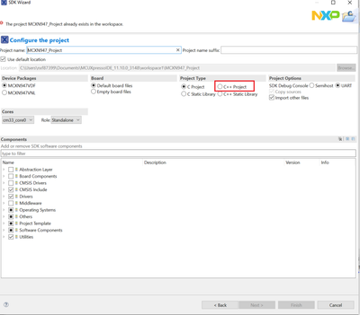

Prajwal123
I have created a new project with .cpp file and compiled. It is not detecting the tx_port.h even though I have included its's path in the includes for both compilers
8,298 Views
Harry_Zhang
Hi @Prajwal123
When you create a new project, did you select C++ Project ?
