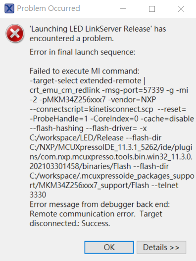

Dear
I use MCU Link to flash the MKM34Z265 and it keeps failing.

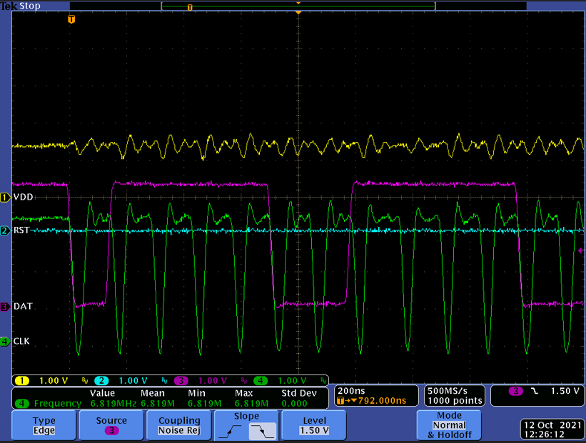

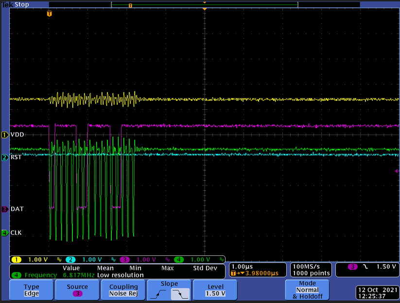

I have measured the signal of SWD as follows, it seems that there is communication, but it will fail.

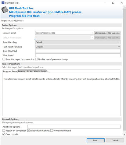

Hi @Kris_Ke ,
Please try to use GUI flash tool to make a whole erase.

jingpan
Hi @Kris_Ke ,
Does the erase success?

My board and TWR-KM34Z75M both can't connect successfully.
If can't connect successfully, how can I erase the MCU?

Kris_Ke
Hi Jingpan
The TWR board can use OPENSDA to flash and debug.
So you can see I remove the OPENSDA jump connect and try to use MCU Link to flash.
It just show can't connection succeeded.

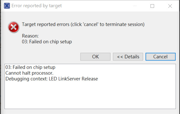

Kris_Ke
Dear @jingpan
I had try it, but still show connect fail.
