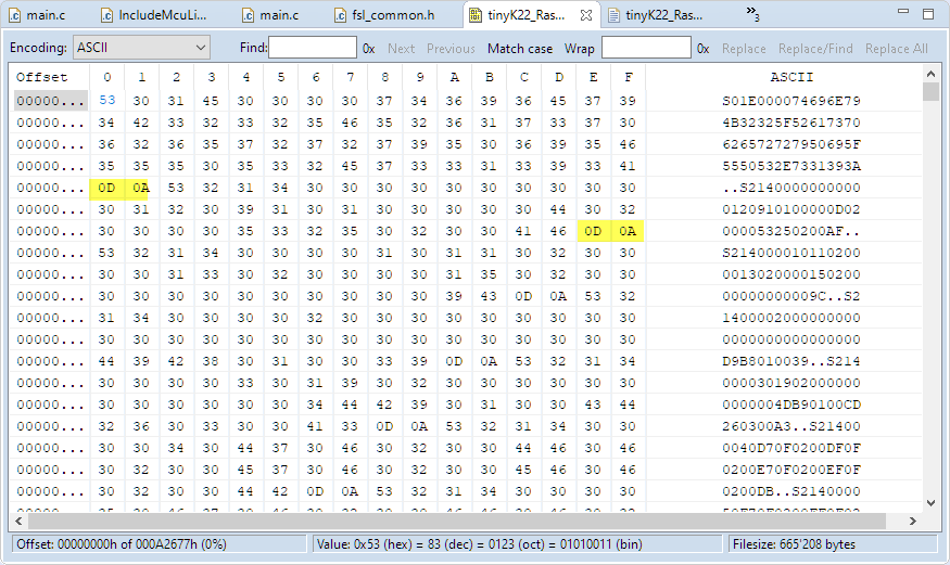

christopher_hes
Is there a way to specify the EOL character?  I am wanting the output to match the format of an output file from Code Warrior that specified the EOL character as DOS(\r\n).
17,579 Views
ErichStyger
Specialist I
The IDE uses the GNU objcopy tool (see GNU Binary Utilities  for its command line arguments), and afik there is no option to change the line endings. I believe it is controlled by the host machine. I just checked on my Windows machine and there is \r\n present:
I hope this helps,
Erich
