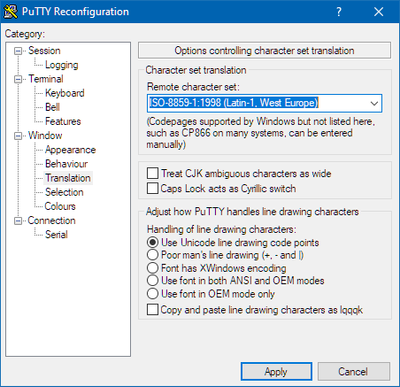

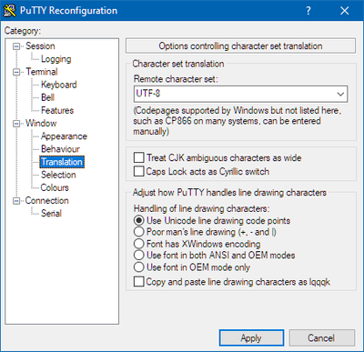

The bytes will be sent over the UART. Now to see it you have to configure your terminal.
Below I show it with PuTTY:
The first line is with ISO-8859-1:
The second with UTF-8:
So it is important that you have both sides (code and terminal) using the same.
