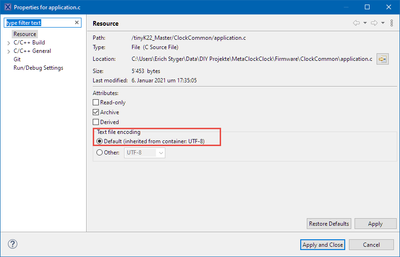

Just to add to this and give an example:
Source file is set to UTF-8: (is the default anyway):
That way I can write extended characters to the file.

First, make sure you editor is set to UTF-8 text encoding (Window->Preferences, General->Workspace encoding options are towards the bottom of the screen)
You can then enter characters directly in your string using the following using ALT and the keypad to enter the character code:

Kratz
My text editor is set to UTF-8 and has been as the default selection.   "alt + 132" successfully produced an "a" with the umlaut dots producing the correct letter in the array.  However the umlaut letter is not compiling or displaying correctly yet.  The letter turns into a Japanese character.  I can tell you know understand what I am trying to do.  What else can I try to make it format correctly?
